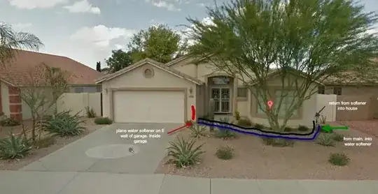

My main water supply on my home is located on the east wall of the home, whereas my garage is located on the west side of the home. There is no water softener loop in the home, and in Arizona most water softeners are put in the garage on newer homes.
I would like to put in a water softener but I'm uncertain that I should re-plumb my water into the garage and back to the east wall into the house.
The way I see it I have two options:
  1. Plumb from the mains on the east wall, under the landscaping and into the east wall of the garage. Then into the softener and out, under the landscaping into the east wall of the house.
  2. Place the water softener behind the east backyard fence (outside), and plumb the east wall main through the fence and into the water softener. Then water softener to the east wall of the house.

This is a crude drawing of option #1. enter image description here

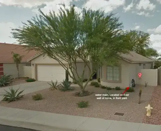

This is the location of the water main, as you can see its on the east wall in front of the backyard fence. enter image description here

If it were me, I would definitely put the softener in the garage. Protecting it from weather, critters, and extreme temperature variation seem reason enough. But to also have it where you can easily monitor it daily seems reason enough again to locate it in the garage.
But the water meter looks like it is above ground: Maybe the climate is safe against freezing? I am under the impression that all of Arizona is desert climate, which means below freezing temperatures are possible overnight most days of the year.
You only need to run one pipe from the water meter to the softener. From inside the garage, you should be able to connect into the system more directly than going back to the meter. In fact, would the water heater be in there too? (I don't see an exhaust for one maybe because there is not enough resolution in the photos.) If it is, you can put a T fitting onto the cold feed into the water heater and distribute softened water from there. Cap off the end near the water meter.
As for digging and burying in the front yard or running it under the house, I would expect running under the house is easier and cheaper. Does it have a crawlspace?
wallyk
  • 12,319
Okay I will try my best on this one. Living in an arid climate does create quite the change in temperature, do you ever get below freezing there? Code up here is at least 18" underground and sleeved if the water line is not approved for underground. I would suggest PVC sch80 pipe as I believe that is approved. The pressure loss is also minimal for the length of pipe in PVC but the number of elbows you are proposing, which I am counting 9 is a total friction loss of about 38 feet of head which is 16 psi. Now I am not saying you'll loose that much off the piping but the calculation suggest it. That is the garage application. Now on average from a water softener you will also lose about 5 psi. I understand the aesthetics your house is important, but I would keep it outside behind the fence if you guys down there have weather that doesn't go below freezing. If you do I would box it and put heat trace on the softener and lines. I hope this helps.
