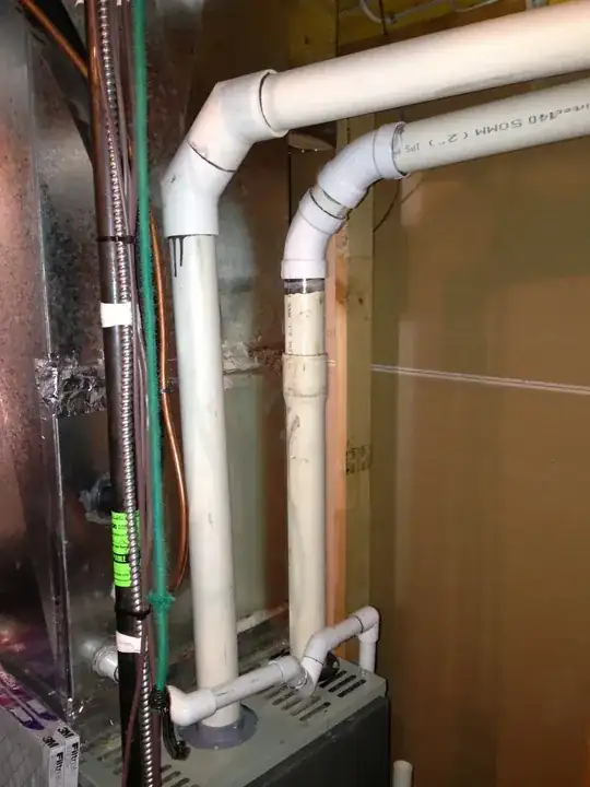

Update Pics of my TPR.
And it looks like where it connects to the wall is leaking. Any idea how to fix that leak. Is that solder?

  • Got it! Yea, so I think I'll put in the expansion tank. I just editted in pics of where the TPR flows through the wall and out side, and it seems like that join pictured is leaking. I the the wall side pipe is copper (hard to tell cause it's painted), not sure what the heater side pipe is. Any ideas how to fix the leak or join them together more securely? Solder? – SDSHuge2.0 Mar 04 '23 at 14:25
  • Should not be a big deal, since water should not regularly flow in it. Yes, it's copper pipe, some of which has been painted, you'd have to remove the paint, get it apart, and re-solder it ofter cleaning up the inside and outside of the joint. But since it should literally never flow outside of the emergency failure mode, a minor leak should not be an issue, until it's time to replace the water heater. – Ecnerwal Mar 04 '23 at 15:04
