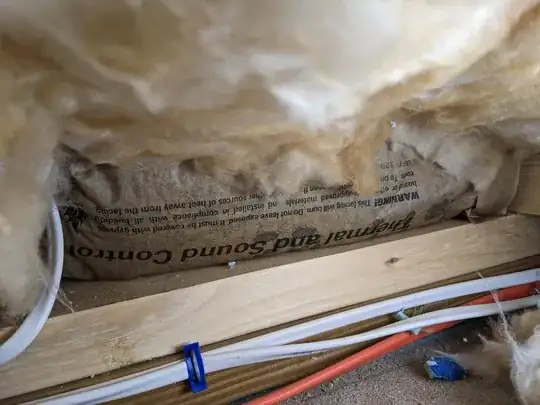

Here is a picture of where the insulation in the ceiling would get in the way of me creating a continuous barrier across the wall to the ceiling: a picture of where the insulation in the ceiling would get in the way of me creating a continuous barrier across the wall to the ceiling
Here is what it looks like in one of the joist cavities. A picture of what looks like in the joist cavity
Note that there are still some gaps above the wall that I am planning to add insulation to before I install the vapor barrier.

  • My house was built in 2019. I think the joist cavities were already done as you described. I edited my post to include a picture of the cavity. Does it look to you like it is done as you described? – user2704238 Feb 23 '23 at 03:06
    @user2704238 thank you for the update. Looks like it's FG batt with facing, and the facing serves as vapour barrier. There's no rigid foam behind it, right? Sine you have foam board against the wall, you don't need, and shouldn't add further vapour barrier. Remember, by code you are not allowed to leave the rim joist cavity & wall unfinished, because it says so on the rim joist's foiled insulation, and in the wall's XPS tech sheet. (Flammable hazard, and the insurance cares if there's a claim) – P2000 Feb 23 '23 at 06:39
  • where do you see this flammable hazard on xps? https://www.carlislesyntec.com/Document-Viewer/owens-corning-foamular-extruded-polystyrene-xps-insulation-product-data-sheet/05fde6b0-224c-9221-cba5-039b55d5b586 – Fresh Codemonger Feb 23 '23 at 09:05
  • Yes, it looks like a faced FG batt to me. Should I check behind it to see if there is foam board, or should it not matter since the facing is already acting as a vapor barrier? What do you mean when you say I am not allowed to leave the rim joist cavity and wall unfinished? I plan to add drywall to the wall, and a drop ceiling above. Does that qualify as finishing the rim joist cavity and wall? – user2704238 Feb 23 '23 at 13:18
    @user2704238 as for finishing, yes drywall is fine. As for the faced FG batt, there shouldn't be XPS behind it, otherwise you risk trapping moisture, so check. – P2000 Feb 23 '23 at 14:19

  • Okay, so I checked behind and there is no foam board, so I think I'm good. No vapor barrier needed will save me some time and effort – user2704238 Feb 24 '23 at 03:01
