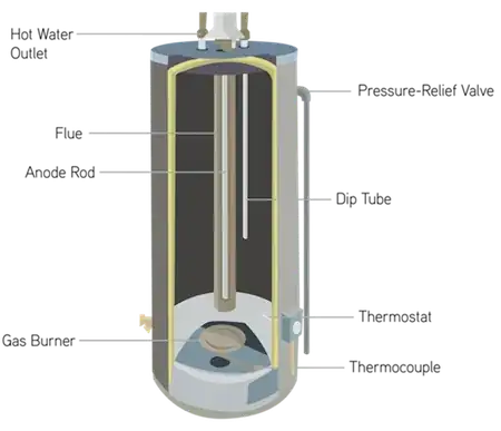

My concern, which wasn't well articulated, may have been based on the assumption that there are a lot of internal workings in the heater itself, somewhat like this:
image courtesy of americanwaterheater.com. No endorsement intended or implied
While it appears that the majority of gas, tanked water heaters are probably more like this:
image courtesy of mrrooter.com. No endorsement intended or implied
i.e., I thought there were a lot of internal gubbins that might get broken if transported horizontally, while it appears that, most likely, I'll be buying a very simple (non-condensing) model that will have very few internal components to break if they're laid on their side.
