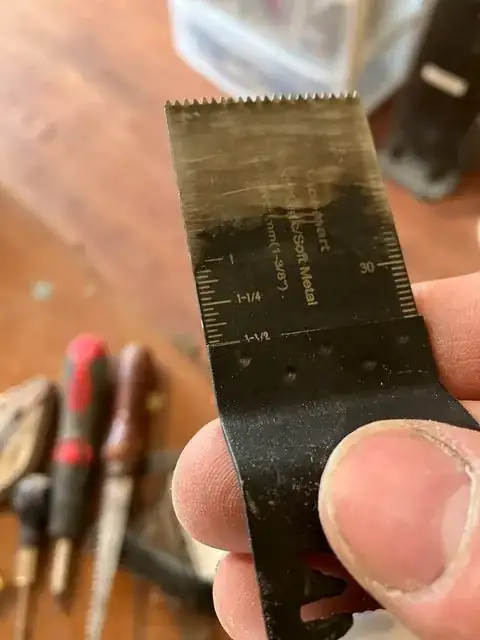

Is there any good method of sharpening these things?
blade

As Leah Bolden from See Jane Drill shows, this is easily done using a tri square file. She shows her technique in this video.
Basically, you use a triangular file to file new teeth. This even works on a blade where they have been ground almost flat. She recommends clamping the blade between two pieces of wood and using those as a depth guide.
Like Leah says,
"you can do this."
P2000
  • 15,754
  • 51
SQB
  • 878
    That video is an excellent find and it answers the question. I took the liberty to include a descriptive screenshot. If you don't like it, feel free to remove. – P2000 Mar 09 '23 at 14:52
  • Are the teeth really just triangles with no cutting edge to them? I haven't really looked at the blades carefully to notice. – Nelson Mar 10 '23 at 00:37
    @Nelson - you can give the teeth a cutting edge by filing at an angle / rather than perpendicular | as shown in the image. Alternate between using / and \ angles to cancel out any distortion. – Torben Gundtofte-Bruun Mar 10 '23 at 10:12
    Probably best to use the finest hacksaw blade you can find - that has worked well for me, as it leaves a square tooth, with a good cutting edge. – MikeB Mar 10 '23 at 10:41
    Are you suggesting, @MikeB, that one use a hacksaw blade to sharpen the teeth of the oscillating saw blade? – FreeMan Mar 10 '23 at 12:28
  • @Nelson Yes, they are (often) just triangles. The cutting is done by the tips of the triangles, which are cutting edges (think of them of working rather like the end of a chisel scraping the bottom of the cut), and the vertices of the teeth, which are cutting "points". Traditional handsaws have this tooth geometry too, usually with adjusted angles to help cut more on either the pull or the push of the stroke. Some have more complex tooth geometry, with more faces on each tooth, which makes them more difficult to sharpen by hand. – Conrado Mar 11 '23 at 14:41
  • @FreeMan Yes, I am, was that really not clear? – MikeB Mar 13 '23 at 09:40
