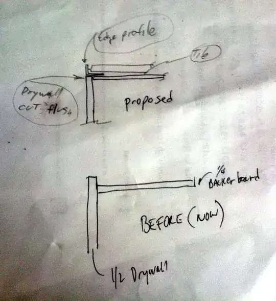

You can use the edge profile pictured, in place of surface bullnose. You would adjust your tile to end short of the corner (equal to the edge thickness of the profile.

  • I don't have a surface bullnose :( Not sure how I'd properly use edge profile like you described... Since the backerboard sits lower than drywall, I'll butt against an uneven cut of drywall, and will end up with a gap between this and drywall. Are you saying that grout should fill that gap? Are there any profiles like this: http://syrota.com/photos/diy/3.jpg (note height difference)? – Serge Apr 13 '13 at 20:58
  • Do I understand that the drywall/wallpaper is proud of the backerboard (by __ amount?) and that after tiling the tile will be proud of the wall by 1/8 (but contained by the drywall?) It seems like you should just cutoff (neatly, with multiple new blades) the drywall flush with the wall prior to tiling and then butt the edge profile flush to the wallpaper wall. Caulk or grout the small gap between the edge profile and the wall. – HerrBag Apr 14 '13 at 12:32
  • The profile in your drawing is know as a "carpet" tuck transition (where carpet and tile are on the same level, the carpet tucks under the raised section) . I don't understand why you want it – HerrBag Apr 14 '13 at 12:35
  • The problem is that it's not a corner. It's a wall on the same plane like so: backerboard ▄▄▄▄▄█████ drywall. That's why this carpet tuck transition would've worked great. I'll try to see how caulking the gap would look, and may be this is the route I'll take. Thanks! – Serge Apr 14 '13 at 18:09
  • Ahhh. Glad I asked. How close is the grout to the thinset? Perhaps mix a small batch of grout to bed the profile against the wall (filling its side), while using thinset at the same time to set the bottom of the profile/tile – HerrBag Apr 14 '13 at 18:23
  • You then sponge off the edge of the profile, maybe use a thumb tack or 2 to hold the profile down af the top, until you get there with the tile. – HerrBag Apr 14 '13 at 18:29
  • I ended up going with your suggestion of just butting it to the drywall, and then caulking the gap. – Serge Apr 15 '13 at 13:28

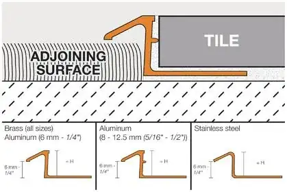

For the sake of completeness, here's the alternative way of accomplishing this: Schluter RENO-TK
Schluter RENO-TK
I'd prefer this one (exactly the offset I have), but unfortunately could not find it anywhere locally, and tile installation was already scheduled.
