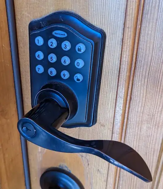

I have a Honeywell door handle with keypad. To open the door I lift the handle up instead of the intuitive pushing it down. I asked the person who installed it to fix that and they checked and told me that is the way it's supposed to work.
Not believing them I asked my handyman to check and he too told me that's how it should operate.
I still don't believe that is how it should work. Before I open it up and fiddle with it myself I'd liked to be armed with the knowledge of what I should be looking for or how this might be happening.

    Just to confirm - it only opens by turning the handle so the free end moves upward, and not pushing it down? Or does it open either direction you turn the handle? – Criggie Mar 20 '23 at 01:59

  • Hmm, most handles like this I've seen can go both up and down. Guess it varies by brand. – Darrel Hoffman Mar 20 '23 at 13:47

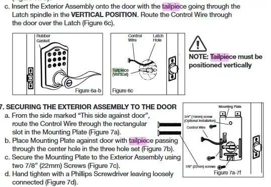

The handles are installed correctly. The issue is that your "tailpiece" was not installed correctly.
Check to verify that your lock's tailpiece was installed vertically.
If installed Horizontally then your lock will not function correctly.
https://content.interlinebrands.com/product/document/10164/3581622_Installation.pdf

  • Are these instructions for the Honneywell lock of the OP? – Jim Stewart Mar 23 '23 at 01:20
    This is the correct answer. I've installed hundreds of such locksets, and if the actuator bar is 90 or 180 degrees out of position this is the result. – isherwood Mar 23 '23 at 13:06
  • Model 8734401 is the Oil Rubbed Bronze version of the Honeywell door handle with keypad that the OP asked about. The ASIN identifier on Amazon is B01N4WCYQO. – Earl Mar 24 '23 at 17:52
