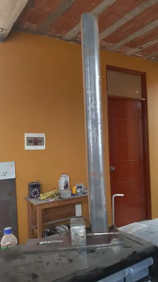

The next two images show the mounting points (circled in red) for an L-shaped desk and a shelf on the 2 walls. Because it was impossible to get the anchors the same height, you can see the need for the slot in the 2" flat stock.
left wall right wall

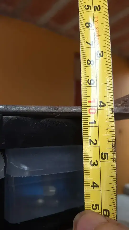

The next 2 images show the measurements of the materials.
Tubeflat stock I know the tub can support the 3/4" shelf. What I'm not sure of is its ability to support a 3/4" or 1" desktop that's 2' wide, with no legs.

  • It'd be more helpful if you sketched out where the desk will go, and where the leg (singular?) will go. – Huesmann Mar 21 '23 at 12:52
  • I added another Image. I think this makes it clear, now? – Mr.GfCs Welding Mar 21 '23 at 14:49
