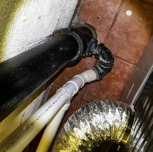

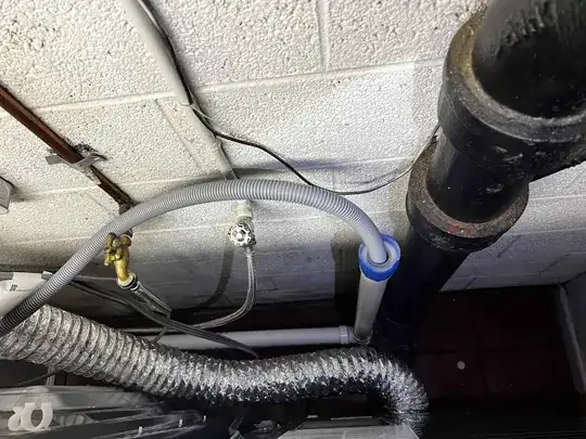

I moved into a new home with laundry room in basement and started to notice occasional wafting of sewer gas out of the laundry drain pipe. It is an older home built ‘58. It looks like there is no p-trap. How could this be? How should I correct it?

  • Please add more photos including washing machine drain connection, where smells are coming from, and what pipes we are seeing in the photos. Also, is the brown tile a floor or the wall? – Armand Mar 22 '23 at 01:52
  • Brown tile is floor – user164651 Mar 22 '23 at 02:07
  • Photos added - odor comes out where the drain tube for washer goes in – user164651 Mar 22 '23 at 02:14

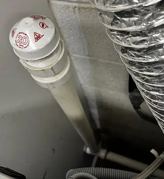

  • Could you post lower-down views of the area where the two white pipes connect to the cast iron? Also, does the horizontal white pipe drain or connect to anything other than the vertical pipe with air admittance vent on top? – Armand Mar 22 '23 at 03:45
  • In general, I think adding a p trap above the current area where the white pipes join should do the trick, but you have to be careful to avoid a setup that will act as a siphon and not leave any water in the trap. Perhaps a trap on the horizontal pipe and the standpipe shifted over to feed into it? The actual plumbing experts here should have solid advice for you. – Armand Mar 22 '23 at 04:01
  • Rotated the first 2 images to their proper "floor at the bottom" orientation - makes it easier to figure out what's going on... – FreeMan Mar 22 '23 at 11:51
  • I wonder if it would be OK to just put an AAV at the top where the washer current drains, and add a P trap down the pipe near the tee, with a vertical stack for the washer. – Huesmann Mar 22 '23 at 13:51
  • "How could this be?" Somebody DIY'd it and didn't know/bother to install a trap. ;) – FreeMan Mar 22 '23 at 15:23
  • Armand - the area with the AAV drains to a sink in adjacent bathroom behind the wall – user164651 Mar 22 '23 at 15:53
You should investigate if the old cast iron pipe has a trap of some sort below the brown tile floor (if there is a basement or crawl space below this floor). In all likelihood there is not such trap present but checking makes sense in case there is some type of failure there.
Since the existing merge of the white PVC pipes to the cast iron piping (via the few shown black fittings) is so close to the floor you may be faced with having to replace some of this white PVC piping. It is probably going to require adding two separate P-Traps, one for the vertical line feed from the washer drain stand pipe and a separate one in line with the horizontal section that currently feeds into the stand pipe. There just does not look like there is room to place a trap below the horizontal to stand pipe Tee.
