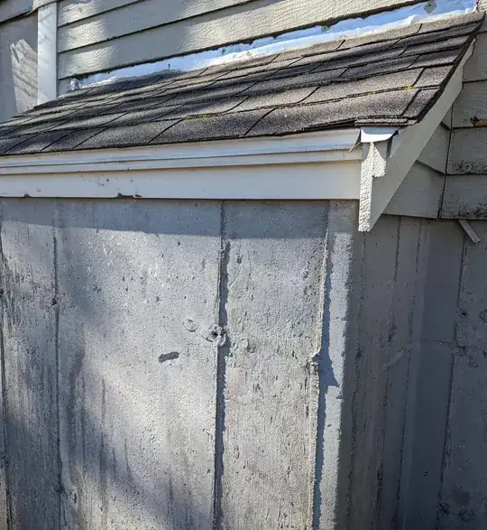

My houses concrete foundation has a small extension, which sticks roughly 2-3 feet out from the rest of the foundation for a space of about 4-5 feet. This results in roughly 10 sq ft of additional basement space beyond what the floors above have. There is a small "roof" on top of this space; it is framed with wood and covered in shingles.
Currently these is no insulation in this space at all, and this "roof" is a source of heat loss (anecdotally, and based on thermal imaging). It seems the right thing to do would be to insulate here to mitigate this... but how? It's a sloped wooden structure covered in shingles that keeps rain and snow out of the interior, but it is not at the top of the house and doesn't have a soffit/vent. Is it really a roof?
Does there need to be a moisture/vapor barrier (and which way should it face)? Would foam board or rockwool/fiberglass be more appropriate? Do I need any kind of baffle to allow air flow? (The top of this "roof" meets the bottom of the siding on the house)
I'm in Massachusetts; winters are typically between 0-30F (occasionally a bit colder, especially with wind chill) and summers are typically 70-90F (occasionally but rarely a bit over 100).
The "roof" bit is about 5-6 feet above the ground directly below it and along most of this side of the house, but is about level with the ground just a couple feet away at the corner and around most of the rest of the house.
Rough sketch of the shape
Exterior
Interior
Underneath

  • @keshlam Added some pictures. – yoozer8 Apr 11 '23 at 01:56
  • Fascinating. No clue why it exists; it seems nothing but liability. The roof seems to be at least somewhat insulated, judging from the picture...? It will lise heat at a rate dependent on the temp. difference across it, so I'd still be tempted to insulate between that area and the rest of the basement and make it essentially an unconditioned closet/crawlspace. Is it actually _useful_ space? – keshlam Apr 11 '23 at 02:11
  • @keshlam The wall it butts up to is insulated (mostly; it has a few gaps I need to address), but the roof itself is just the wood and shingles (and hopefully a moisture barrier between, but I don't know for sure) – yoozer8 Apr 11 '23 at 02:17
  • Ah. Wasn't sure what I was seeing in the photo. In that case, treating it like an occupied attic space might be worth considering: insulation with air channels between it and roofing to prevent rot, or put up a ceiling that has a layer of insulation (foam board insulation with plasterboard beneath it for fire safety) and leave the cavity open as unconditioned space above that... Just brainstorming; I tjonud still be tempted to install an insulated wall and door, call it a weird maintenance closet, and not try to make it make sense. – keshlam Apr 11 '23 at 02:26
