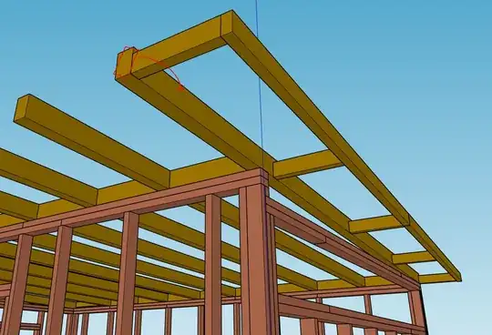

I'm building a garden shed with 2x4's and have some roof overhang on the sides. Due to an inadequate design, exacerbated by a change in the design on the fly, the overhangs are slightly bending downwards.
Overhang bends downwards
The problem is that the overhang is only attached to the outermost roof beam, which pulls the beam down and sideways, out of plumb thereby causing the overhang not to be level with the rest of the roof. Design view

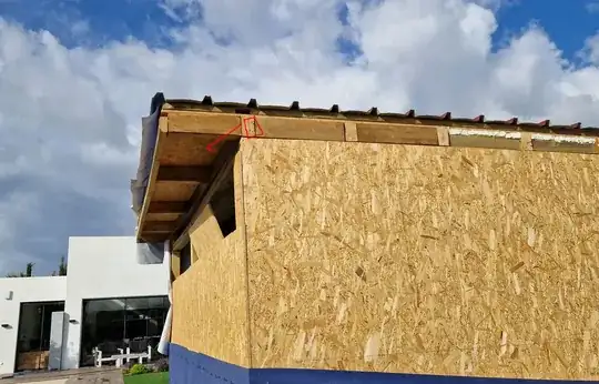

I've tried solving the issue by fixing the beam to the top plates with more screws and a metal fastener, but the problem persists. Metal fastener

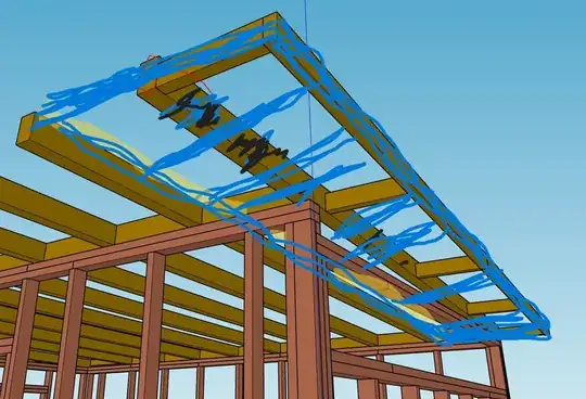

It looks like you have a metal roof, so there is not much weight there. You have 2 choices:
  1. Remove the roofing and roof decking back far enough to access the second rafter in. Build a "ladder" for your end rafter and facia with 2x4s perpendicular every 2 feet. Build up your end wall so the angle is filled in and the ladder has something to sit on. Finish the roof. I attached a pic with my idea very poorly drawn in. The blue and yellow show the ladder the black is the rafter that is eliminated and then filled in with blocking. ( not an artist obviously)
Roof
