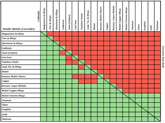

If you look at a metals compatability chart you can find the answer.
https://www.monarchmetal.com/wp-content/uploads/Galvanic-Corrosion_2.png
Looking at the chart your only sure option appears to be screws made of aluminum. Or screws not made of metal (plastic) or coated in plastic.
