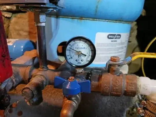

hand dug well pump pressure gage

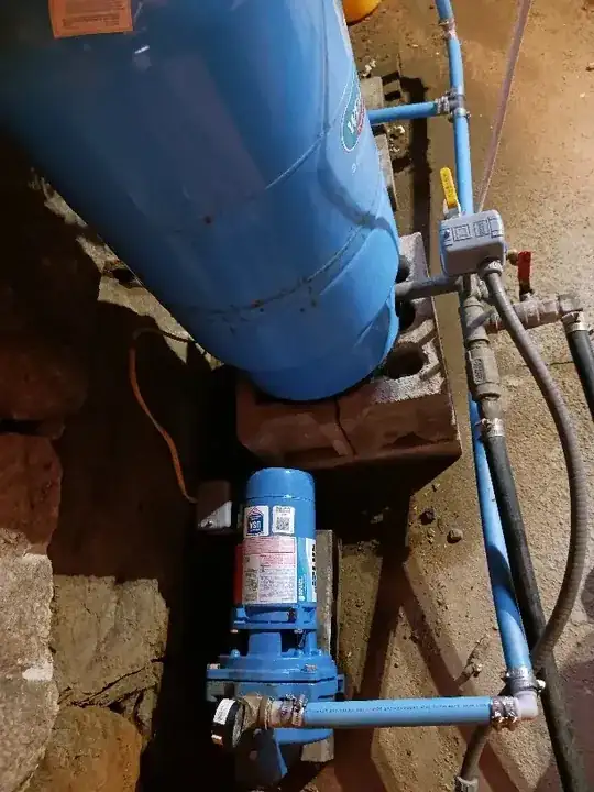

another pressure gage
Just added these pics. One picture is of the pressure switch on the 20ft hand-dug well reading 40ish. The other pressure gauge is at the base of one of the tanks reading 25 psi. Seems this may be low. How do we increase the pressure? Both wells are hooked up to the house we seem to have the same issue of whether both pumps are on or just one.
People are washing clothes it's now not filling and the pressure is reading 45psi on hand dug and 30 psi on artesian both up about 5 psi.

Seeing it's a well, you need to look at your well pressure tank. There should be a pressure gauge on it. Watch what it's doing, it should maintain between 40 - 60 psi. Possible problems is your well pump is wore out, or your pressure switch isn't maintaining adequate pressure in the tank. You say you have two wells. Are they both connected to the house?

  • I see hints of galvanized/iron pipe, is the house plumbed with pipe or tubing? galvanized or iron pipe will corrode closed after many years causing pressure drops because of flow restrictions. Also check your gauges, there should not be that much pressure difference between two parallel pump systems. – Gil May 21 '23 at 21:16
