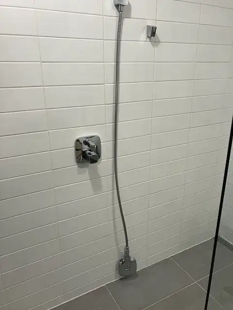

I'd like to shorten a Hansgrohe Techniflex hose. The spot that the pipe nipple comes out of the wall is too low and the handshower can hit the tile.
Here's a pic. I already broke one hand shower this way.
hose too long

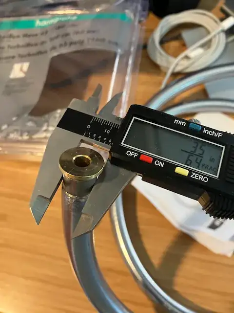

The fitting on the end is shown in the attached pics. It's clearly a brass piece that fits into the cut hose end, with a collar crimped to hold it in place. The od of the hose is a hair under 5/8 inch (I don't know the id). The crimped collar is 35/64 final dimension (aka 0.546 decimal inches).
Anyone recognize this setup? I think I can get the brass insert out by cutting the crimped collar, and I'm wondering whether a PEX crimper could secure it (after cutting the hose). Looks like it is a stainless steel ring.
I'm thinking maybe it is a "stainless steel press sleeve" like Viega or Apollo make? I guess this might be the 1/2 nominal size?
Techniflex crimped collar show crimped size
Techniflex crimper collar

Maybe this:
Apollo sleave crimped
    A decent suction cup (or ceiling mount, depending what you've got) hook to hold the hose a bit higher seems much less likely to cause grief than attempting to re-crimp a hose where you probably can't source the correct crimp sleeve and crimper and are attempting to hack it with what you can get. – Ecnerwal Apr 21 '23 at 16:37
    Those press fittings usually require special(expensive) equipment. If they are like hydraulic hose fittings, they require high pressure. Most pex fittings leave a bump/ridge and are not smooth for skin. – crip659 Apr 21 '23 at 17:54
    Very unwise to do such a thing, but I must admit I do not understand the problem you are have with this handheld shower. – Jim Stewart Apr 21 '23 at 21:06
  • @JimStewart the hose is too long, so the handheld unit hits the floor if it's dropped. You know, things in the shower can get slippery. – Huesmann Apr 22 '23 at 13:54
  • I don't drop mine, but if I would drop it, it would strike the rubber (now PVC) non-slip mat in the tub/shower I use. I wash our 25 lb dog in the tub and benefit from the length of the hose to wash the underside of the dog. But if the length bothers you, the best solution would be the stick-on hook proposed in the comment by @Ecnerwal. – Jim Stewart Apr 22 '23 at 15:50

All sorted!
Showing reinstalled handshower now not touching the floor.

The Apollo sleeve is quite a bit bigger than the factory one.
Apollo 1/2 uncrimped compared with factory sleeve crimped
The factory sleeve is much more like the Viega 3/8 stainless steel sleeve (~14.7mm), the od of the barbed insert is exactly the same as Viega 3/8, so I ordered some of those. But no way the 3/8 viega slips over the OD of the technifex tube (which is way thicker than pex-b), and in any case I could not find a reasonably priced crimper for 3/8 Viega pex crimping.
Uncrimped Viega 3/8 sleeve compared with crimped factory sleeve
FWIW, I also tried the copper rings in the 3/8 size but those also wouldn't slip over the end. I tried compressing the end in a few ways but that was hopeless. Eventually I decided just to try the stainless steel Apollo 1/2" sleeves.
