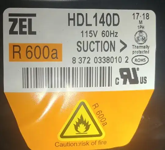

I have a ~6 year old chest freezer (Magic Chef HMCF7W2) that has stopped freezing. I read online that a common reason for this was the PTC Starter going bad, and replacing it will fix the problem. I was unable to find an exact replacement, but read that using a RCO410 3-in-1 would work, at least enough to verify if the start is actually the problem or not. I ordered the RCO410 and installed it, but it seems to still not be working, although differently.
When the unit first stopped working, it just sat there doing nothing. No noticeable noise. When I first installed the RCO410, I bypassed the thermostat as I did not have a good way to connect it. The freezer ran for a couple of minutes before shutting off, but the compressor was very loud compared to before. After it shut off, I noticed the compressor was also extremely hot.
After letting things cool down, I re-installed the RCO410 with the thermostat and now it will click on loudly for a second, hum for another 10 seconds or so, then click off.
Does this indicate that the compressor itself has gone bad or lost it's refrigerant, and thus not worth trying to fix?
OEM Label: Image of OEM label
OEM Wiring: Image of OEM Wiring
RCO410 Wiring: Image of RCO410 Wiring
Compressor Label: Image of Compressor label

Good job troubleshooting. It sounds like the motor or compressor is bad. I don't believe it would be economical to fix.

It could be the refrigerant has leaked or at least partially that would make the compressor hot as the refrigerant lubricates and helps dissipate heat.
Mine got hot when the refrigerant needed refilling.
On YouTube videos people use a vacuum pump to remove the air plus any refrigerant into a bag (save ozone layer) for safe disposal and using an adaptor refill with refrigerant (amount shown on your label 1.34 oz) the fridge/freezer. You might have to fit a valve if filling pipe crimped as they usually are. This is what I will do with mine as I have all the equipment.
