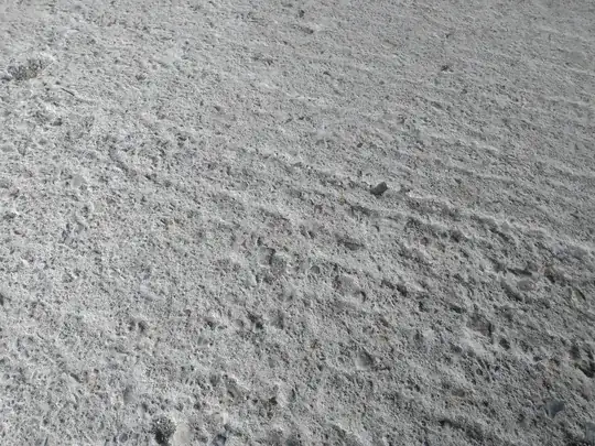

I am about to commence work on extending my garage. I will be pouring a new concrete floor and trying to get as smooth a finish as I can. However, this will flow up to my existing garage floor which was very poorly laid.
It looks like when they were installing it, they just tamped it vaguely flat and nothing more. It's very difficult to move things around on castors (tables, wheel dollies, engine cranes) and wanted to know what my options were. As I see it I can:
  1. Break it all up and repour the entire garage as one big (steel reinforced) slab
  2. leave it as is and pour the new extension up to it so there are two surface finishes
  3. pour concrete on top of this to smooth is off
I'm reluctant to go with option 3 as it will raise the height of the floor and the floor is already a little higher than the outside. Much more and I'd have trouble getting cars in. Plus it would need to be thick enough to supports cars on it? Option 1 seems the best, but its a lot of work and double the money.
Are there any other options available to me? Is grinding a thing? I'm in the UK (Scotland) so that limits things a bit.

This surface isn't a result of poor workmanship. It has been severely degraded, either by overwatering, a faulty mix, or chemical damage. This is why you see so much aggregate (and aggregate pockets).
Resurfacing it may restore it, but it may also just be a costly delay to replacement of the slab. I would have a local expert take a look in person before going to the trouble.
