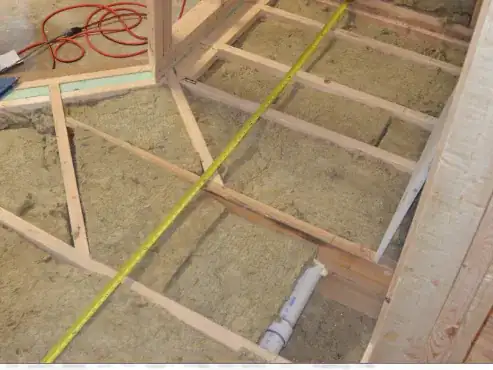

My 2nd floor dryer vents outside of house but into the small enclosure between the roof and ceiling of the attached porch overhang (see photo below). There is no vent coming out of the overhang.
Dave K
  • 111
  • If the dryer is located towards the middle could it be vented to the side of the porch on an angle? Or would vent have to be straight line out of the front of the porch overhang? Front does not have enough space plus gutter is in the way – Dave K Apr 25 '23 at 13:40
    Are you sure the dryer vents into that space? Can you tell us, and show with better pictures please, where the vent goes into the wall? It would be strange for a dryer to be up against a front wall by in that location. And the pipe might go up the wall and vent out somewhere else. Please tell us more, and post better quality pictures! – jay613 Apr 25 '23 at 16:04
    I'd dry a load on high, something with lots of moisture like towels. After about 10-20 minutes, inspect the outside of the house to see where the steam is coming out of the house. – rtaft Apr 25 '23 at 21:58
    I checked the roof, no vent. I’ve checked under the porch below and no vent there either. So I placed my arm into the hole that vents from the laundry room and out the house. It’s a short hole that seems to stops inside the enclosed area of the covered porch. – Dave K Apr 26 '23 at 10:16
    Is this space fully enclosed or is it open at the bottom? It wasn't clear from the picture. You called it an enclosure but I just want to make sure. – user253751 Apr 26 '23 at 14:35
  • Do you have a sketch of where your vent runs? Any chance you could extend the actual exit from "house structure" down through the soffit of the porch overhang? – Huesmann Apr 26 '23 at 14:38
  • Do you know if the porch was added on later? I can't really tell from the pictures. – Lio Elbammalf Apr 26 '23 at 14:52
  • No it was added when the house was built. – Dave K Apr 26 '23 at 15:00
  • Yeah I think the solution is extending pipe to the soffit of the porch. Or 90 degrees and out the side of the porch ceiling. – Dave K Apr 26 '23 at 15:28
  • It is a fully enclosed space. It’s the space between the ceiling and roof of the attached porch. There’s an enclosed space due to the roof having a pitch. – Dave K Apr 26 '23 at 15:59
  • @rtaft on a cold day would be even better, perhaps a quiet one as you might be able to hear something from outside – Chris H Apr 27 '23 at 07:52
  • If it's a gas dryer, you may have a carbon monoxide problem too depending on how that overhang is designed. – rtaft Apr 27 '23 at 09:43
  • It’s an electric dryer – Dave K Apr 27 '23 at 13:06
  • Please don't substantially change your question after you have answers. If you now want to know what to do about it, post a new question and provide views of the porch attic. – isherwood Apr 27 '23 at 13:42

Solution: Open that attic space, extend vent to and through side wall. Or down thru the porch ceiling, but that will be a problem if you ever want to enclose the porch
keshlam
  • 27,539
  • 46
  • 94
  • Not enclosing the porch so venting through porch ceiling seems like the solution – Dave K Apr 27 '23 at 13:05
    @Dave This is not a good idea. The steam will rise then condense on the porch roof ceiling and adjacent wall even if it's not enclosed. That ceiling is probably not air tight so it'll get in there again too. You want it to have as clear a shot of getting away from the house as possible. Plus you probably want that porch to be usable space and now you've got a cloud of steam there. Going a few extra feet to a vent on the side of the porch overhang is the better way. – aquaticapetheory Apr 27 '23 at 13:59
    Agreed, out the side seems worth the relatively small amount of extra effort even if it does mean having to patch the ceiling. – keshlam Apr 27 '23 at 15:25
  • The side of the porch is my preference. But that means a 90 degree vent pipe that goes an extra 10 to 12 feet to get to the side. So I’m not sure if this is too long or not. – Dave K Apr 27 '23 at 16:13
    @Dave The old dryer in my basement is blowing through 8 feet (or probably more) of crappy flexible duct that's not routed in any organized way and it does just fine. 10-12 feet of smooth rigid duct with a single 90 deg elbow should not be a problem. If you're worried, you can insulate it and/or add a booster fan but it should not be necessary. – aquaticapetheory Apr 27 '23 at 16:53
  • @Dave Here is something a bit more solid for [dryer vent guidance](https://www.nachi.org/dryer-vent-safety.htm) – aquaticapetheory Apr 27 '23 at 16:57
  • I added a second picture in the main post that illustrates in a highlighted yellow line where the dryer is and how the vent would have to go 90 degrees to get to the side of the porch ceiling. – Dave K Apr 27 '23 at 18:36
