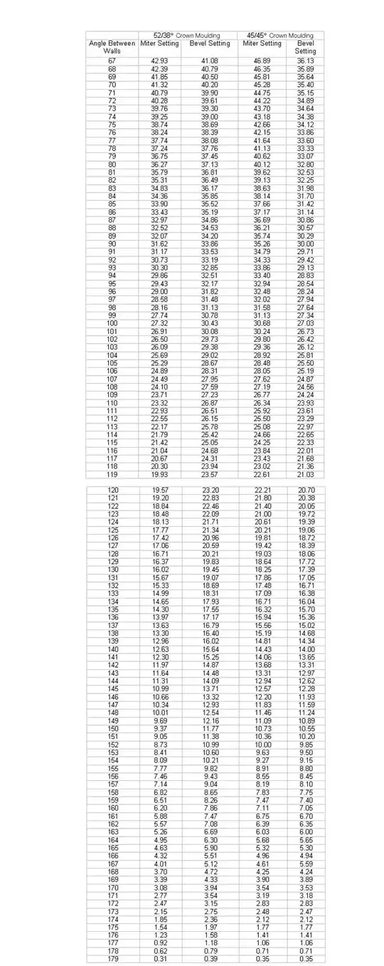

Cutting on the flat:
If you are cutting on the flat there are lots of mitre/bevel charts online like this one:

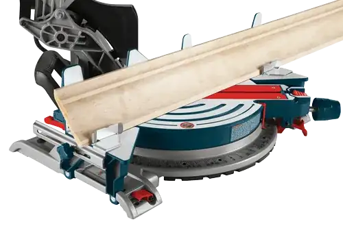

Cutting Nested:
Have you tried nesting your crown?
Hold the crown at the angle it would be on the wall, and just do a normal mitre (no need to worry about bevel).
This is how I prefer to cut it, but everyone has their preferences. You can buy different stops and clamps for setting this up to be quick and accurate (or make your own jig). As well as most saws nowadays have attachments for their saws for this.

I am cutting it on the flat, so I should be using 31.62? I'll give that a try. – gebuh Apr 21 '13 at 21:10
On the flat would be 31.62 mitre and 33.86 bevel if your corners are 90 degrees – ryanwinchester Apr 21 '13 at 23:17
Or just 45 degree mitre if you nest it ;) – ryanwinchester Apr 21 '13 at 23:18
1Don't forget that ceiling is down when nesting.. – HerrBag Apr 22 '13 at 03:06
