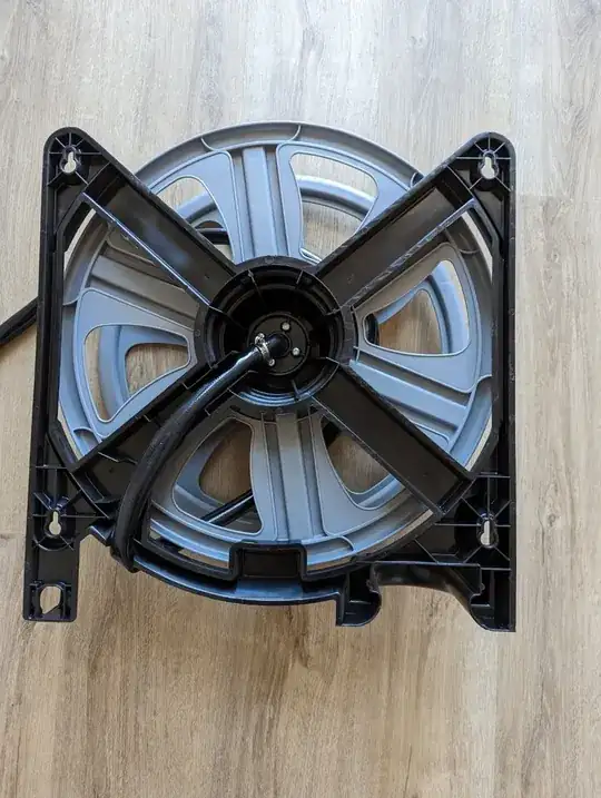

I bought the hose reel in the pictures below and I'm looking to install it on my exterior wall that has vinyl siding. I tried to do some research on the best way to attach hardware to vinyl siding and couldn't find much (or my Google skills aren't great, that's a likely possibility. Based on the limited info I was able to find I can think of two options:
Option 1
Of course, the reel didn't come with any instructions but given that this thing needs to hold a decent amount of weight and that the mounting holes are 16" apart I think I can safely assume I need to install it onto studs so:
  1. Drilling some holes and attaching the reel directly against the siding
  2. As mentioned here I could cut larger holes and use some kind of spacer/standoff (thin PVC pipe?) to keep the reel off the siding but attached to the house
Before I go drilling/cutting holes in my siding I wanted to see if either option is worth doing or if there's a better option to get this thing attached. Thanks!
Pictures Hose Reel Front Hose Reel Back Siding

When I mounted exterior speakers to vinyl siding I inserted some thin wooden blocks underneath the siding. Get a vinyl removal tool to pop out the siding. Place your block underneath. This will give you a solid surface to screw into.

Just don't. Put a post in the ground and mount to that. Putting holes in maintenance-free siding should be a last resort.
  • This feels like a non-answer but I decided not to punch holes in the siding because it just seemed like I would be asking for trouble. Thanks for the advice! – amura.cxg May 02 '23 at 03:22
  • I agree, it doesn't answer your question. Call it a frame challenge. – isherwood May 02 '23 at 12:44
