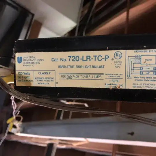

I am trying to replace the burnt out fluorescent bulbs in my basement with compatible LED lights, but I'm having trouble finding a type that works.
These are the bulbs I'm replacing: sylvania workshop f40 24618 e5l2
This is the ballast: Universal Manufacturing Corp. Cat. No. 720-LR-TC-P
I'd really rather not have to rewire or replace all the fixtures in my basement, but I've had zero luck finding an LED replacement bulb that works. Any help is greatly appreciated.

    See https://diy.stackexchange.com/q/271764/18078 (including the comments below the accepted answer) but realize that **if your ballast itself is bad**, you'd have to replace the bad ballast to use a "drop in" LED replacement, while all you have to do with a direct-wire type is remove the bad ballast and make a minor wiring change. – Ecnerwal May 02 '23 at 20:03
  • See also: https://diy.stackexchange.com/q/104851/18078 which might qualify as a duplicate. But not exact, so no VtC from me. – Ecnerwal May 02 '23 at 20:14

Executive Summary
Save yourself a headache: remove the ballasts and rewire the fixtures to directly power LED bulbs designed to work without a ballast.
Longer Version
I had exactly the same problem: I had a mixture of old-style and newfangled electronic ballasts and it was a total crapshoot whether a bulb that worked in one would work in the other. Mostly not on both the one and the other and those that did work would randomly just stop working.
The "compatible ballasts" lists that the manufacturers provide are not only mostly wishful thinking, but you have to take the fixture apart to find the ballast model number anyway.
Bypassing the ballast involves clipping a couple of wires to/from the ballast and hooking them up to eachother without the ballast in the way.
The wiring diagram for removing the ballast is included in the package or is directly on the sleeve for the direct-wire LED bulbs. There are only two wires coming into the fixture in the first place; one goes to one end, the other to the other. Rocket science it ain't.
You've been meaning to clean them up anyway; might as well rewire them too! Putting them back up without the ballasts is way easier, too; those old ones are heavy!
Please take the ballasts to be properly recycled! The old ones are full of incredibly nasty stuff; the older the nastier. The electronic ones can have lead solder depending on when and where they were made. Think of it this way: if you throw them in the trash, they will come back to haunt you through your faucet.
ssteinerX
  • 331
Wait. Have you been trying different plug-and-play or universal LED replacements, and they haven't been working???
If you try a "direct-wire" LED yeah, they're not going to work... but if you've been trying P&P or universals, those should work - and if they don't work, the problem might not be the fluorescent tubes. It may be the ballast.
I say that because the tube doesn't look burned out.
I would try swapping with other fixtures. If it proves to be the ballast, then your wish "to not re-wire" isn't going to happen. You'll either be installing a new ballast, or wiring the fixture for ballast-bypass and using direct-wire LEDs. But that's not hard: all yellows to white, and all red/blue to black. Blue wire nut for the yellows and orange wire nut for the red/blue/black. Mind you, that's for that particular rapid-start ballast; other fixtures vary.
