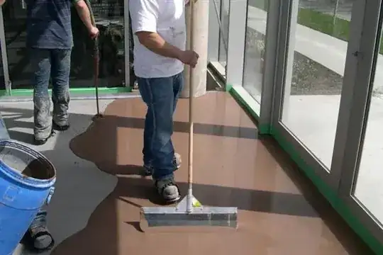

Even though you say it is 3/16", in my opinion, it would make life easier to just use an SLC
Ultraplan Easy

    +1 for the pic.. Self levelers are nice, maybe overkill for such a small area. A couple of coats of thin set or one coat of a medium bed mortar would fill 3/16s – HerrBag Apr 23 '13 at 03:39
    Yeah, you would likely be fine using just your thinset if you don't want to buy extra stuff for a small area. I prefer the ease of SLC, but then again I've usually got extra of that kind of stuff in my workshop or garage somewhere. However, if buying an extra product medium-bed mortar versus SLC, I'd go SLC :) – ryanwinchester Apr 23 '13 at 03:43
    My advice, from personal experience with levelers is 1) buy a "gauge rake" to spread it around with. Using a squeegee will give horrible inconsistent results. 2) as in the picture buying "spiked" sandals is another good idea so you can walk over areas that have already been spread without getting the material on your shoes and causing massive gaps to appear. 3) spritz the floor with a descent amount of water prior to dumping the leveling compound to give yourself more work time. Concrete will immediately begin to suck the water out of your mixture and can cause it to set too fast. – TugboatCaptain Apr 23 '13 at 06:35
