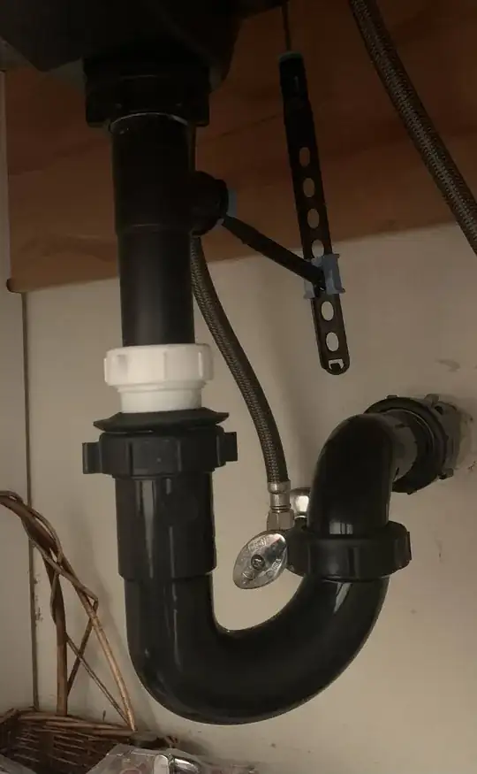

enter image description hereI just replaced the toilet, sink, and faucet in my bathroom and I now smell sewage from the sink. Everything is basically the same, although I had to get a drainpipe extender - still have p-trap though. Ideas?
Added pic but let me know if the angle is what you need and thank you!
Follow-up: since the sink and faucet I installed in the other bathroom don’t have this issue, ordered those exact products and going to reinstall to see if this remedies issue. Did not have to do the drainpipe extender on the other one and it was more exactly centered. Thanks for the thoughts and will update after I do that.

  • Can you post some side view photos of drain pipe connection at wall? It's hard to see what's going on with the nuts there. – Armand May 08 '23 at 07:17
  • Where the short white tailpiece extension meets the black pipe below it, it looks like there is a disc shaped washer(?). I'm pretty sure that should be immediately below the black plastic nut instead, so tightening that nut compresses it to make a seal between the white pipe and black trap pipe below it. You may have a similar issue where pipe connects to wall, which might let sewer gas leak out there. – Armand May 08 '23 at 07:22

    What is the black flying saucer above where the white and black pipes meet? That will not be the source of the smell but if it is an indication that you have not packed the various joints with appropriate washers (some slip, some flat, some integrated) THOSE could be your problem. Do an experiment: Remove all the trap parts, and cover the trap adapter coming out of the wall with a plug if you have one or freezer bag tied tightly to the pipe. If the small goes away, you know the trap is the problem. – jay613 Jun 07 '23 at 13:45
  • It's definitely a bad day if you have to start acclaiming Delta. "extra grommet" that I've never seen before and looks like *the one rib that's left* from a flexible that's been cut. Take the p trap loose, take all the nuts off and show me all their grommets. But if it doesn't even leak I don't see how you'd be getting enough air to smell. What's the blue stuff sticking out of where the drain stop arm enters and why doesn't it have a nut on it? – Mazura Jun 10 '23 at 23:39
