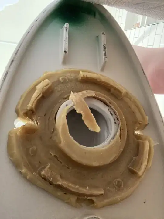

Photos below: Wax ring after I pulled the toilet. Repaired toilet flange with insert, mounted on top of sub-floor.

It looks like the wax ring was placed on the flange and then the toilet was misaligned when it was placed on the ring and then straightened out. You can see in your photos that there's heavy wax on one side and little or no wax on the other. I have always positioned the wax ring on to the toilet and then lowered the toilet into place. The toilet needs to go straight down with no sideway motion. Marking the floor with masking tape where the toilet will go helps to do that.

    Thanks JACK. The wax thickness around the edges of the drain do look uneven to me too. The area that is the thinnest is also the side that the toilet was leaking water from. – BlueDog May 09 '23 at 22:32

  1. Looking at the compressed wax ring against the bottom of the toilet stool indicates that the wax was compressed very thin in some areas. This is likely due to the flange sitting at a level higher than the floor and when putting the stool in place initially it may have rocked some and left an area where the wax squeezed out too much and left an area that did not stay sealed.
