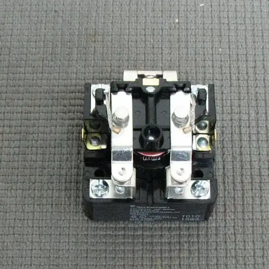

In practice, the terms usually refer to the way the devices are internally constructed. In this usage, a relay refers to a switch where the switching element stays connected to one of the terminals, while a contactor refers to a switch in which the switching element disconnects from both terminals. A relay often has 3 terminals per switch (common, normally open and normally closed), although the 3 terminals are not always all exposed to the user and this is less common in power relays. A contactor always has 2 terminals per switch. Both devices can have multiple switches per coil, although relays with more than 2 poles are somewhat rare, while 3 or 4-pole contactors are fairly common.
diagram of relay and contactor
Edit: in the comments you ask specifically about the Trane RLY03346. This photo of the inside of it shows that the terminals on the top are permanently connected to the switches with 2 wires, as such this is a relay (as also indicated by the letters 'RLY' in the model name).
Trane RLY03346

  • Yup, that's the relay a couple of big HVAC supply houses list as a [Contactor](https://www.hvacpartsshop.com/rly03346-contactor/?setCurrencyId=1&gclid=CjwKCAjw9pGjBhB-EiwAa5jl3DrQFZ3H7kX6W_uYlQGkmGdzbEbgJ2asrOCsFvVxTXnaewTJRY5j6hoCzgsQAvD_BwE) while many others call it a relay. – TheBigCat May 17 '23 at 17:08
