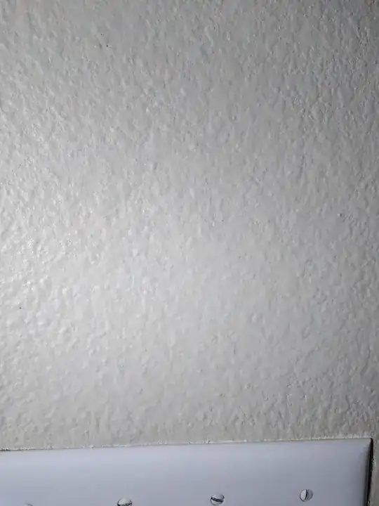

My walls are very old prefab 3 inch thick concrete. I want to make a floating bathroom countertop. My guy helping me remodel, is not an expert (I’m in Costa Rica) He says I can’t build this because the walls won’t hold up my sink. I think there must be a way?! Maybe to build a backing to attach the countertop to?

  • 3" concrete brick, or 3" hollow-core concrete block, or 3" hollow-core with cores reinforced and grouted, or 3" solid poured reinforced concrete? All would be 3" concrete wall, but they will perform very differently. – Ecnerwal May 20 '23 at 13:20
