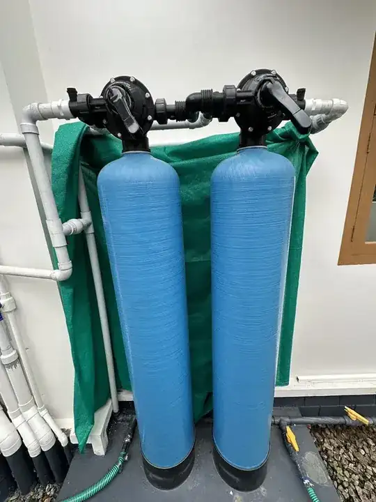

Based on these results, we decided to install an outdoor On-line water filter unit (see attached image). One of the cylinders in the water filter unit contains dual media of Activated Charcoal and sand, while the other cylinder contains Katalox.

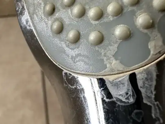

Although the filtered water appears clear, we're still experiencing issues with the formation of white scales and the water hardness. The toilets are staining, and I can't wash my car as it leaves behind white scales. Unfortunately, we haven't been able to find any other source of water apart from the borewell.

Water plant
Stains on bathroom fittings

https://www.uswatersystems.com/katalox-light-filtration-media.html states:
for high level filtration, color and odor removal, iron, manganese, hydrogen sulfide removal, efficient reduction of arsenic, zinc, copper, lead, radium, uranium and other radionuclides and heavy metals.
Nothing about it serving as any form of softener, nor even as a TAC (template assisted crystallization) non-softener that reduces scale by forming stable nano-crystals without changing the water chemistry.
So there's no particular expectation that it would soften the water. Nor does carbon or sand. If you want soft water, you'll need a softener in addition to your current filters.
Your test results do indicate a reduction in iron, (probably the Katalox) and an improvement in taste (probably the carbon, unless the disagreeable taste was the iron,) an improvment in color that could be attributed to both media, and a reduction in turbidity.
