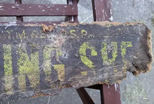

I'm doing some work on an external side doorway/threshold - the house was built in 1912 but had some additions and renovations in at least the '70s, maybe the '50s as well.
As I was cleaning out the area between the door and the exterior concrete steps, I found this loose piece of insulation, along with some old siding and wood scraps. They definitely weren't helping much anymore.
At first I thought it was meant to say INSULATING SHEET, but I think it might be INSULATING SHEATHING. Who knows, maybe it's INSULATING SHEEPDOG. I was also hoping the top text was a brand, but it looks like TM REG US PATENT.
I'm planning on just scrapping it and handling it as minimally as possible. I got curious, though, and tried to see if I could find anything specific about it online, with no luck.
Is this fiberboard sheathing? Are there any precautions I should use besides gloves and a basic dust mask? Is it possible to tell what brand this is?

Doesn't really matter what brand it is. It's fiberboard sheathing--low density in the grand scheme of fiberboard. It was probably installed in the 70s or 50s. It wasn't original. Also known as Buffalo board.
It's a respiratory irritant but isn't likely dangerous. Use a dust mask. Cut it with a circular saw or utility knife.
