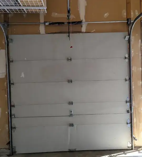

I just came back from a week out of town and noticed my garage door opener isn't working. When I press the button it moves about an inch then gives up.
I tried disconnecting the electric opener and opening it manually but it's suddenly incredibly heavy to move manually (didn't use to be this heavy). I was able to move it a few more inches using a huge amount of effort, but I couldn't get it open further than this so I put it back down.
I've checked all the wheels on the sides of the garage door and they're moving smoothly, but just in case I sprayed WD-40 on them. Didn't make any difference.
Any idea what this could be? How can I fix it?

    A question with a picture that allows us to see the problem and answer the question - good job! +1 – Ecnerwal Jun 06 '23 at 23:24
  • When you get this replaced have them replace the large single spring with two slightly smaller ones, that way if this happens again to one spring you will still have SOME lift. – gnolt Jun 07 '23 at 19:01
  • Yeah, pretty sure there's not supposed to be a gap in the middle of the spring. :) – Martha Jun 08 '23 at 16:03

Your torsion spring broke.
Whether these are DIY or not is debatable.
That they can kill (or merely injure/maim) you if you lack adequate care is a fact.
That one needs to be replaced.

    In addition to the spring, there appears to be some damage to the bottom panel of the door, like somebody ran into it with a car maybe? It looks minor, but that kind of damage might be enough to make it not sit in the track very well, and might have caused undue strain on the spring which ultimately could be what broke it in the first place? – Darrel Hoffman Jun 07 '23 at 13:49
  • Track misalignment can indeed break the door. Given the danger of spring replacement, any additional issues will simply cause the new spring to break again, and you risk harming yourself a second time. This is one of those things that's just not worth the risk because it is so infrequent, but so dangerous. – Nelson Jun 07 '23 at 16:08
  • The door binding will make the door hard to move, and may damage *the opener* by making it work harder if you don't check manual operation and safety stops on the opener twice a year as you should. The springs "just break" typically after 10,000 operations or so - the door binding does not directly stress the spring and break it - that's a misinterpretation of what the parts do. All you can really do to reduce spring breakage is keep it from rusting and not operate the door more than is actually needed. Unwinding and winding each time the door goes up and down is the stress on it. – Ecnerwal Jun 07 '23 at 16:16

The spring is broken and fully unwound. You can tell because of the white line spray-painted on at the factory while it's unwound.
