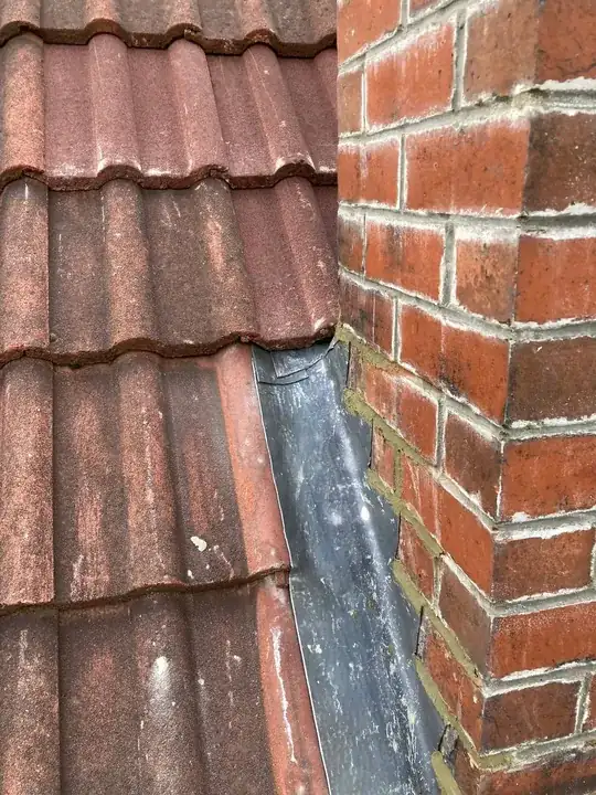

For reference here is an external view of one of the chimneys taken by the contractor just after he had finished:
External view of chimney
NB - For background I'm not sure the damp spot issue is the water coming via the chimney stack anymore as there are also similar damp spots away from the breast on adjacent external walls; not really a question for this post just including for thoroughness!

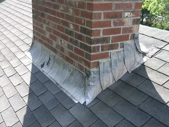

  • Cut a straight diagonal slot into the bricks. Make the metal straight and bend over one edge to insert into the slot sealing it with caulk or mortar. No gaps, everything is (ideally) sealed. Like this: straight flashing
  • Have a stepped flashing a bit similar in appearance to what you have there but each step is a separate piece of metal and the top one overlaps the one below it but a few inches. This way the vertical edge is still open like yours but when the water gets in it just run out over the flashing piece below it (unless there's a driving wind strong enough to move it past the overlap). This is the feature you're missing. Like this: stepped flashing
There is also the matter of setting up flashing and counter-flashing but I don't know what to do with that on a tile roof. Generally you want metal arranged such that it guides water down and sheds it away by overlapping in the proper way. You could probably arrange a flashing such that you see sunlight through some gaps and the water is still kept out but what you're showing is not that.
