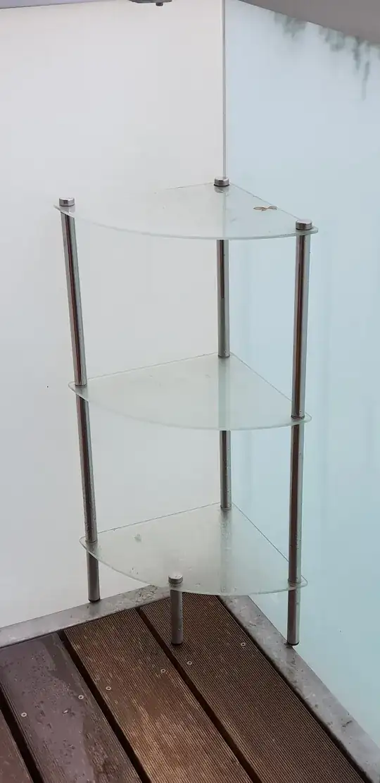

enter image description here I need to "baby-proof" this corner glass bracket by securing it to the glass walls of the balcony, at each of its 3 levels.
Since there are no holes through which to pass any rope/wire, I thought about using something double-adhesive like a suction cup. But I could not find any products that would fit, and do the job.
Any ideas would be appreciated!

    1) I agree with the answer that preventing this from toppling over will only provide a better ladder for the child to climb over the wall. 2) Why do you want to attach it at all three levels? What exactly are you trying to prevent? 3) If you rephrase this as "everything on the balcony must be attached" which is common, and remove the child from the problem, we can focus on the solution. Just state your wind speed .... are you in hurricane country? :) – jay613 Jun 12 '23 at 11:41
    No real good way to baby proof, but the best thing for me would be to basically hang it securely from the handrails. That way, while it won't be on the floor, at least it can't topple over. – Huesmann Jun 12 '23 at 14:12
    great points, thank you. Not particularly windy here, but I agree that it is best just removed from the scenery – z8080 Jun 12 '23 at 14:55
    @z8080, looks like a gap between the foot of the corner shelves and the glass pane. Might not the glass pane flex out a tad, letting the foot slide down between the floor and the pane? – chux - Reinstate Monica Jun 13 '23 at 21:20

If we let OP do the parenting and focus on attaching a tube to glass in a harsh outdoor environment:
Get a security anchor base plate AKA "cable lock anchor". The linked one is just an example, you can find others. Remove and discard the included adhesive pads. They won't withstand heat and sunlight from behind.
Use a UV-curable glass glue to attach the anchor to the glass. Do some research to find glue that explicitly lists long-term resistance to UV light and heat as one of its features.
Use a metal hose clamp (not plastic cable ties) to attach the pole to the anchor.

    But only if you own the glass partition. Otherwise you might have a hard time removing the thing if you ever need to. – arne Jun 13 '23 at 07:18
    *I need to "baby-proof" this corner glass bracket*. OP asked how to baby-proof it. The answer is "don't do that". – RonJohn Jun 14 '23 at 05:49
silicone. that's how aquariums are put together, sheets of glass are joined with silicone at the edges.
You can always test it yourself: silicone each of those three pieces of glass to the wall, and let it cure, then try to pull the shelf down yourself. If it can hold up to a human adult, then the toddler will be okay. If it fails the test, or when the toddler moves to college, you can use a razor-scraper to remove the silicone.

  • +1 This is the easiest route to go. I use a bead of silicone on toilets for the exact same reasons. Few bucks in caulk, scrapes off/comes off with thinner, requires no tools, doesn't rot or rust, is elastic, and easy to clean to boot! – J D Jun 13 '23 at 21:13
Ignoring the context and answering the question strictly as asked, consider attaching it to the ground instead of to the glass wall. It's hard to discern materials from the photo, but the legs look metal. If you weld a nut inside each of the legs, you can run bolts up through the wood to anchor it down.

    Angle bracket on the rear leg. Screw it to the deck first then mark where you need a hole in the leg. But with the context it should be replaced with a garbage can and that thing put inside it. – Mazura Jun 14 '23 at 15:20
