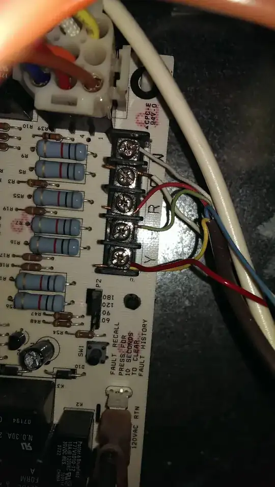

I have central air and heat, with a Nest thermostat. My system has Y, G, R, C and W wires coming out of it: circuit board
which are wired into my Nest like so: Nest wiring

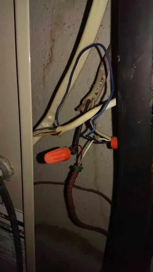

In between, there is a splice where the C wire is spliced with electric and another wire runs from that splice back to the C hookup:
C splice with eletric

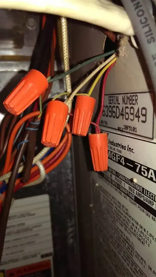

And then the other wires are spliced with a new set of the same color:
other splices

  • Did this work with the old thermostat? In your third image where the `C` wire is spliced with electric and some other wire, where do those cables go/come from? Are you sure the Nest is configured properly? The `G` wire is the fan signal wire, so make sure that wire has continuity end to end. – Tester101 May 01 '13 at 11:10

I would first try touching the R and G together at the thermostat board (the wires coming out of the wall) and seeing if the fan turns on. If it does, then all the wiring is correct. If it doesn't, then I would try to do the same thing with two short wires that have been attached to the thermostat control board R and G terminals. If it still doesn't, then the problem is in the furnace. If it does, then you have a loss of continuity somewhere between your thermostat and your furnace on the G wire (because the heat and A/C work, so the R works). I don't have a Nest myself, but I know that not all thermostat systems make it obvious how to run the fan without cooling or heating.

    R + G makes a clicking sound in the furnace, but produces no other sounds or airflow. Tried it directly on the board as well, with the same result. – noah May 25 '13 at 23:02
  • If you've got a click in the furnace, that more than likely means that the relay that controls the furnace is engaging. However, the fan itself isn't spinning, so it's likely between the relay and the fan (or the fan itself?). Do you have a wiring diagram for the furnace? – Aaron May 29 '13 at 18:36
  • The fan works when other functions of the circuit board call for it, just that the separate 'g' contacter isn't 'relaying' its signal, which means to us mortals: **replace the board.** – Mazura Apr 11 '15 at 01:02
