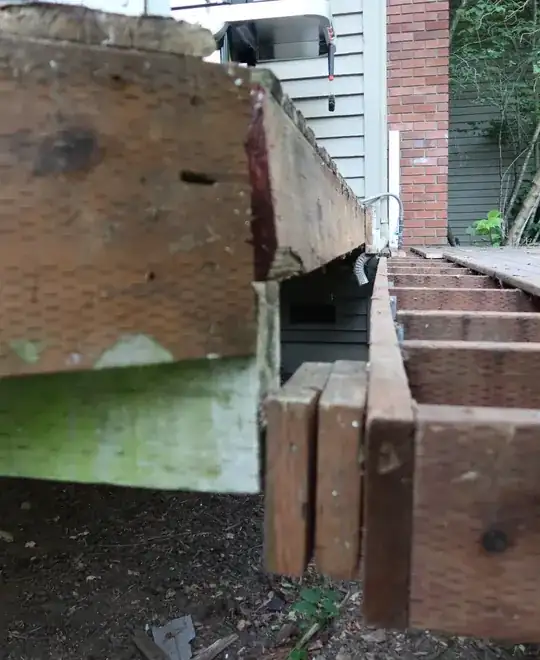

At a corner of my house I have a two-level wrap around deck. It is not far off the ground, 2-3ft. One level is about a foot above the other.
This question is about the lower level. It is 15.5 feet long, but it only contacts the house along a 3.5 feet-long ledger board.
This hot tub deck connects with the upper deck in only one location, 8 ft out from the house. That connection seems to be pretty weak.

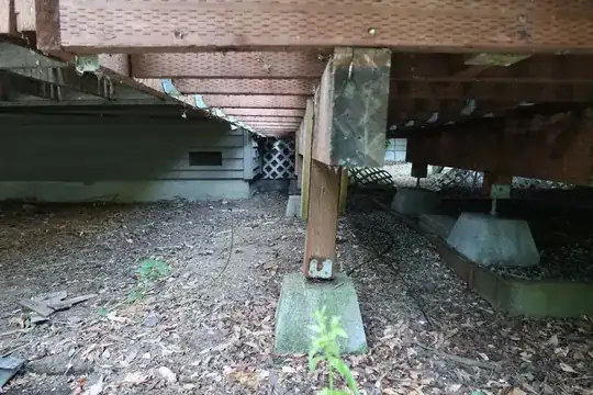

All posts supporting the hot tub deck underneath tilt away from the house a bit.
While the posts are tilted, the distance between the upper and lower decks is the same in all places, which makes me think that either the posts were tilted from the beginning, or the tilting is the result of ground moving underneath. (But the ground would not move uniformly to tilt all the posts, would it?)
Is this something of concern? Anything that should be done about it?

The lean in the posts roughly corresponds to what we see as gaps in the connection between the decks and the curve in the rim joist there. I agree that this is a concern considering the massive load of water.
Depending on the other deck for position isn't the right approach. I would be installing diagonal bracing to rigidly hold position. Random, arbitrary connections won't do much, especially with a short deck where leverage is at a premium. You need targeted support to specifically address the movement we see here.

I wouldn't be concerned about the connection between the two decks. It was never intended to be structural. I'd add the missing joist hanger. Considering the weight of the hot tub, I would be concerned about the tilting posts. Correcting the tilt doesn't have an easy fix, expecially if the beams, such as that 4x8, have a twist. I'd be inclined to reframe it, making the hottub support independent of the deck.

  • The hottub has its own support - separate posts and separate beams. But they are also tilting. – Loki Kriasus Jun 29 '23 at 06:24
  • Yeah, I would think about trying to plumb the leaning posts and installing some diagonal struts to keep them plumb-er. Maybe use heavy duty ratchet straps to draw it toward the other deck? – Huesmann Jun 29 '23 at 13:00

You asked another question about attaching stair stringers. When that is done while not structural, it will help tie the 2 decks together.
If all the 4x4 posts of the lower deck are aligned, I would tie them together front to rear to help against tilting further. If they are not I would put blocking between the beams. Basically tie all the support structure together under the joists.
