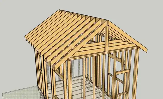

10'x16' insulated off grid "cabin" build. I want to use gable vents for my ventilation because it seems way simpler than a ride beam and soffit vents. I have a post centered on each 10" wall to support the ridge board.
  1. how would I install a centered gable vent around this post?
  2. what other framing do I need in these triangles on the gable ends above the top wall plate?
  3. if I want a foot overhang can I accomplish that by just overhanging my sheathing on the gable end or do I need to build a "ladder"?
I have my walls framed and stood up with some bracing. I am stuck overthinking and over researching roof venting, soffits, rafters, etc.
  • What are the ground snow loads like where you're building this cabin at? – ThreePhaseEel Jul 07 '23 at 04:00
  • Seems to me the easy button is to simply have an offset vent, if your OCD can hack it. If not, have two smaller vents. I don't think you need anything added to your birdsmouths. As to the overhang, I would extend the ridge beam a foot and add fascia boards in front, with a few pieces of blocking between the front rafter and fascia board. You are planning to have a fascia board on the rafter ends, right? – Huesmann Jul 07 '23 at 12:58
  • @ThreePhaseEel 105 - 120 pounds per square foot – Foopysfarm Jul 07 '23 at 17:26
  • @Huesmann yes I will add fascia board. I already have my ridge board purchased at 16', I'll need to find another way to extend it – Foopysfarm Jul 07 '23 at 17:27
  • Plan first, **then** buy materials... If we assume your eave overhang is also one foot, you'll have up to 1,440 lbs of snow loading *just on the overhang.* You'll want some structure for that, yeah. If you design for the potential that it all drifts to one side (as the documents for my trusses suggest one should, as they did) all that could be on just one half of the overhang. – Ecnerwal Jul 07 '23 at 17:36
  • @Ecnerwal, we commonly build 12" overhangs with just fly rafters on new homes here in Snowisota. It's not a problem. Any sag is negligible, as load is balanced across the gable truss pretty effectively. 16" or 24" overhangs get drop gables and ladders. – isherwood Jul 10 '23 at 20:42

  • You had three questions to choose from and you avoided them all. :P Keep in mind that this is a tiny building. It wouldn't take much of a breeze to effectively scavenge the whole thing. – isherwood Jul 10 '23 at 20:29
  • @isherwood meaning letting a breeze through the small space might be sufficient? – Foopysfarm Jul 10 '23 at 23:43
  • Might. Depends on the insulation strategy, local climate, etc. – isherwood Jul 11 '23 at 12:52
How would I install a centered gable vent around a ridge post?
Gable vents are little more than penetrations in the sheathing, and if you're using a commercial grille they pretty much just lay over the surface as a trim and pest prevention component. Wrap your post in something weatherproof and dark colored (so it isn't so conspicuous) and carry on.
FYI, a ridge board doesn't require posts. Its sole purpose is to make holding rafters in position a bit easier, and once the sheathing is on it's rather superfluous. However, a ridge beam would require posts, but it needs to be substantial enough to carry much of the roof's load. You may not need either if you have adequate rafter ties.
What other framing do I need in these triangles on the gable ends above the top wall plate?
Put studs in there at 16" or 24" centers to support your sheathing. You might only need two aside from the post. Once the gap height is below 24" you're good unless you want siding backing.
If I want a foot overhang can I accomplish that by just overhanging my sheathing?
Yes. 12" overhangs are adequately supported by the sheathing and by the fly rafters, which are in turn supported by the subfascia at the bottom of the slope.
  • thanks for you answers. I follow #2 and #3 but I am being a bit dense on #1. Why am I wrapping the post? I am envisioning the post being in the way of the vent? Regarding ridge board vs beam you helped me out over here: https://diy.stackexchange.com/questions/270299/do-i-need-a-ridge-beam-or-is-a-ridge-board-adequate/270331#270331 – Foopysfarm Jul 10 '23 at 22:56
  • The gable vent louver usually isn't weatherproof. You'd want to wrap any exposed lumber to protect it from rain. – isherwood Jul 11 '23 at 12:51
  • won't the post block the vent and be in the way? I'm being dense. Nice bird pictures by the way. – Foopysfarm Jul 12 '23 at 05:04
  • The post would only impede the vent a small amount it's narrow, and it's not necessarily _in contact_ with the vent anyway. – isherwood Jul 12 '23 at 12:39
  • Ended up running vents in the bird blocks between rafters (open eaves) and a ridge vent. Thanks for your help. – Foopysfarm Sep 27 '23 at 03:32
