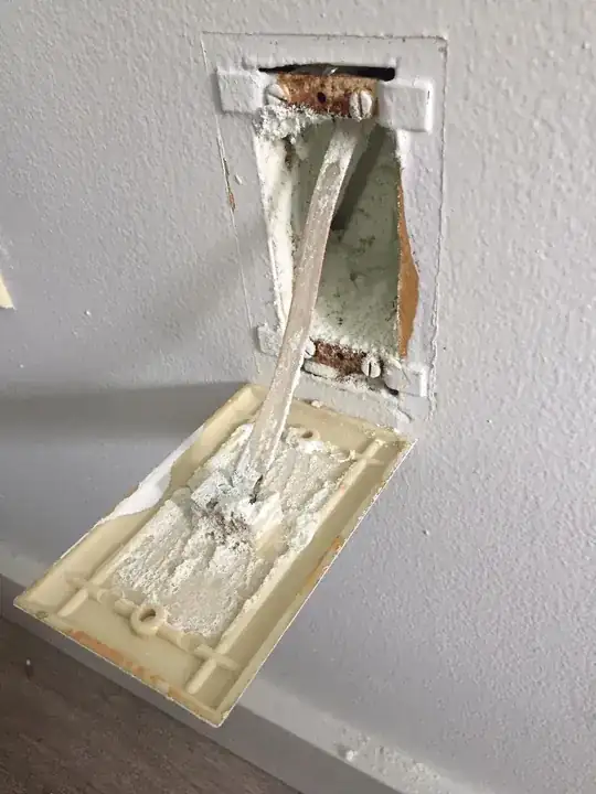

This is my dining table chair. It’s back support rod broke. I tried fixing it with wooden glue but it keeps breaking. Any advise how can I fix it without nails as that can hurt someone’s back. Or is there a place I can find wooden rod like this and fix it?

I would be separating the top rail, then removing that cross.
Once the cross is out then it can have a new bit made as trying to join that broken bit will not be very successful.
Make the new tenons that go into the top rail and glue as reassembling.
