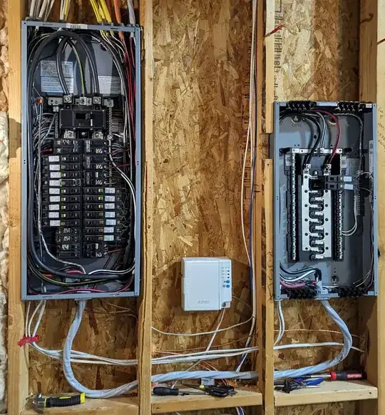

I've just added a 100A subpanel to a house with a 200A main panel, and would like to know if I did everything correctly and up to code before getting it inspected (I'm in WA state USA -- 2020 NEC).
What I installed
photograph of subpanel
It's a Square D HOM2448L125PQGC 125A 24-48 panel with main lugs (but no main breaker). IIUC, you don't need an explicit disconnect (whether main breaker or otherwise) on a subpanel if it's right next to the main panel that feeds it.
Per #3 / #5 THHN and 1-1/4" metal flex conduit for feeding 100A subpanel?, I used 1-1-1-3 AL SER for the feeder.
Wiring the subpanel
I drilled 1 1/4" holes through the studs (1.5" from the edge) for the SER to go to the correct stud bay. This part of the garage is unfinished and it's unlikely that drywall will be added in the future.
I used 1 1/4" knockouts and NM cable clamps + bushings on both panels for the feeder. I didn't staple the SER cable since it wasn't close to any of the vertical studs, but I did tighten the clamps enough to provide strain relief. I used Noalox on the lugs and the tips of the stripped Al conductors before tightening.
Most importantly, I used a torque screwdriver to tighten all lugs to the spec (50 in-lb) per the breaker and bus bars.

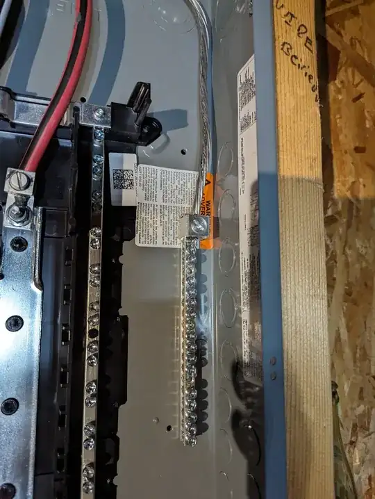

Grounding
I installed one of the provided ground bars on the right of the subpanel. Since this is a subpanel, I didn't attach the screw that bonds the neutral bus to the panel / grounding system.
I didn't install any additional ground rods since it's right next to the main panel, so the subpanel's ground bar is only connected to the main panel's neutral / ground bars (which are bonded there).

I also moved two 15A 120V AFCI circuits to the subpanel to make space for the 100A subpanel breaker. I used 2x 14/2 runs of Romex, with 1/2" knockouts and NM clamps on both panels but no bushing (there wasn't enough thread after adding the locknut to securely attach the bushing). IIUC, bushings are optional for that small size.

  • You don't need new load calcs for what you've done so far. You need them for your envisioned end state, once you fill up the new panel with whatever you plan for it. One calc for the new panel and one for the entire service including the new panel. Do that now so you can balance things correctly as you install or move them. You''ll avoid putting too many large new loads in the subpanel, which will cause it to reach capacity without taking up many spaces. Then you've go no usable space in either panel. – jay613 Jul 15 '23 at 21:40
    While it may be unlikely that drywall will be added soon, someone will want to add some at some point. It would be an added bonus to put protective plates on the studs in front of _every_ stud penetration (both electrical and plumbing). As cheap as those things are, it's just not worth it (IMHO) not to put them on. – FreeMan Jul 15 '23 at 21:41
    Too late now, but you could have just put the sub-panel lugs on the bottom and saved the whole trip around the inside of the panel to get to the top. But no point in changing it now. The inverted "Line" text confirms that this panel can be top or bottom fed. – Ecnerwal Jul 15 '23 at 21:43
15
TLDR: Looks great. The only thing I'm not a fan of is the 100A breaker being directly opposite another large 240V breaker. I understand the temptation to crowd the biggest breakers near the main so they have the least distance to travel on the bus, but buses are overbuilt, and the bigger risk is overloading the thin little bus stabs. If the opposite breaker is 20A I wouldn't worry about it, but larger and I would maybe swap that 240V breaker with two breakers below it.
Now if that breaker to the right is a generator interlock, or a surge suppressor, disregard what I just said - the surge doesn't take any amps (for any amount of time long enough to matter thermally).
IIUC, you don't need an explicit disconnect (whether main breaker or otherwise) on a subpanel if it's right next to the main panel that feeds it.... I used 1-1-1-3 AL SER for the feeder.
Correct... and correct! Common error avoided!
The subpanel wiring looks fine however I'd put a panel over it to provide physical protection.
GOOD! (though this won't be inspected). Make sure you actually checked the spec on each thing (neutral bar, lugs, breaker) as they might differ.
Wait, HOMeline provided accessory ground bars for free?? Must be a counterfeit LOL... no just kidding. That's fine. Yes, either ground bar will carry ground to the other via the panel steel.

  • Thanks for the quick feedback! I put the 100A breaker at the top mainly to leave enough slack for future installs without having to bend the conductors in the already cramped panel. If I were to move it lower, are there any tips and tricks on how to leave slack without having to bend thick conductors? – peter Jul 15 '23 at 20:54
  • Also, do you have any thoughts on the load calc part? Is this relevant at all if I'm adding a subpanel with no new loads? – peter Jul 15 '23 at 20:55
    Panel spaces are 100% irrelevant to the load calculation. Only actual *loads* count. – nobody Jul 15 '23 at 20:57
    @peter I would just move the smaller circuit opposite it downward, and move 15/20A circuits up. Yeah I forgot about the Load Calc. – Harper - Reinstate Monica Jul 15 '23 at 21:19
