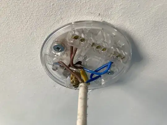

I have two lights in my bedroom on the same circuit with a single switch. One of them (always the same one) will sometimes flicker to the point that it's strobing. It doesn't do it all of the time, and there doesn't seem to be a correlation between it doing it and how log it's been switched on (sometimes it does it straight away, sometimes it can be on for ages and not do it). I am assuming there's no issue with the supply or fuses or I'd be seeing it on both light fittings.
I've tried a different bulb. The bedroom is in an extension that is about 5 years old so the wiring should be fairly up to code and in good condition. I can't access the wiring above it as the attic is boarded and insulated, but nothing should be disturbing it if, for example, there was a loose connection.
There is nothing obviously (to me) wrong with the wiring.
Switch wiring: enter image description here
Good light wiring: enter image description here
Problem light wiring: enter image description here

    I would turn off the breaker and check the connections in both lights just to be sure a loose connection is not the problem. Changing the bulb should have checked that it was not a bad light bulb. Type of light bulb can be useful, LEDs seem to have more flickering problems. – crip659 Jul 17 '23 at 13:06
  • @Huesmann No, not a dimmer. – Darren Jul 17 '23 at 13:35
  • @crip659 The one with the problem is an LED bulb, the other one is an older sytle mercury low-energy bulb. How am I checking for loose connections? Just giving things a pull and tightening them up? – Darren Jul 17 '23 at 13:36
