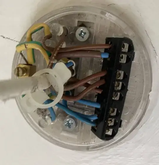

I'm trying to change a UK light ceiling rose in a 1920-30's house and after taking the old rose cover off, the wiring has thrown me. It looks like there's 3 of each live, neutral and earth, and some odd colour choices on the wires. This is the only fitting in the room and is controlled by a single switch. The new rose seems to only need 2 of each wire. Any advice, or is this rose simply not compatible with my wiring? Photo of ceiling rose

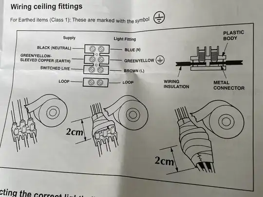

wiring digram from the new fitting

  • Beware, I had a similar problem (although two roses and two switches, but the wiring was of a similar vintage and equally confusing). My attempt at putting a new rose on ended up blowing the mains fuse. – Darren Jul 17 '23 at 13:48
    That was actually a nice job. The guy bothered to put earth sheath on …& even more rare, put a live sheath over the blue on the switched circuit. @Darren - that's current colours, current spec & done very nicely in an industry standard ceiling rose terminal block. It doesn't ever get any simpler [assuming you understand it in the first place;) TBH, it's the instructions that are confusing. – Tetsujin Jul 17 '23 at 15:55
    Also, looking at the 'modern' plastic and style of terminal block... its almost certainly not from the 20s? There's *hardly* any bakelite. – Journeyman Geek Jul 18 '23 at 05:19
    In any event I'm uncomfortable with that leaflet which (a) doesn't provide for daisychained (i.e. paralleled) fittings, (b) is physically different from the rose in the photo and (c) shows a terminal block being wrapped in tape when in practice there would likely be a recess or pegs to locate it in a fixed position. – Mark Morgan Lloyd Jul 18 '23 at 08:52

  • "some odd colour choices on the wires" The house may well be older but the wiring uses completely standard post 2004-2006 colours, widely documented on the web including [here](http://www.ceilingrosewiring.co.uk/ceiling-rose-wiring-new-cable-colours/). Do you have some enclosed fitting that doesn't hang from a drop cord and needs to replace the ceiling rose? – Graham Nye Jul 19 '23 at 14:12
14
You have neutral, live and a switch loop (in addition to ground). Plus a daisy chain to the next light in the circuit in another room.
The neutral block with all the blues has all the neutrals that come from the supply and go to the light and the next light.
The live block with the 3 browns has the live from the supply, has a connection to the next light and to the switch.
The last block with the brown sleeved blue and brown is the connection between the switched live from the switch to the live of the light.
If possible I would suggest keeping the existing electrical connections in place and use them to connect to the new light.
Otherwise check if the terminal block allows for 2 wires into one side of it. That will let you connect together the 3 wires.
If not then your local DIY store should have 3-way wago blocks that you can use instead.
The UK ceiling rose is possibly the most elegant junction box in the world. It has exactly the right terminals for any of three different applications. The entire point is so you don't have to disturb all that when you change a lamp.
Plus the lamp itself, so four, really. That's completely normal wiring for lamp ceiling roses. Ceiling wiring is not designed for the convenience of novices installing their first light fixture. The novice must skill up in order to "play". Now this isn't a code requirement in the UK, but I myself would mark the top two wires (the blue-marked-brown and companion brown) with a distinctive color like orange, since those are switch-loop wires, energized only when the light is to be on.
And did this come from a reputable retail shop? A great deal of stuff which BSI (safety certifier) would most emphatically say is "not for your country", is sold via mail-order, particularly Amazon Marketplace (Amazon, but the "Sold By" is not Amazon).
I would not disturb the rose at all. After turning the mains off, I would cut the lamp cord about 150mm (6 inches) from the rose. Et Voilà, the three wires you are seeking. It should be easy work from there - no need to decrypt the magnificent British ceiling rose. Then you have a lumpy splice; hide that behind the new lamp's dome.
  • "I myself would mark the top two wires ... with a distinctive color like orange" I wouldn't. Orange is not a standard colour to be marking UK wires with. Putting a brown sleeve (or tape) on a blue conductor (or on pre 2004-2006 wiring a red sleeve on a black conductor) is the standard UK way of indicating a switched phase conductor returning from a light switch. The top brown conductor isn't marked as it runs to the drop cord and is regarded as being easy to follow across the ceiling rose. – Graham Nye Jul 19 '23 at 13:56
  • "The UK ceiling rose ... has exactly the right terminals for any of three different applications." That's standard for traditionally wired UK electrical fittings - ceiling roses, sockets (US: receptacles) or light switches; normal, two-way or intermediate (US: 3 or 4 way) all have the correct number of terminals and no connectors are required in the back box. The only exception now creeping in is a neutral conductor in a light switch which doesn't have a smart switch that uses neutral. – Graham Nye Jul 19 '23 at 14:05
As others have said, I wouldn't replace the ceiling rose, since any replacement is going to need the same number of connections (and if you get it wrong, other lights will stop working).
So what I'd do is remove the terminal block from the new light fitting, leaving the 3 wires (line, neutral, earth/CPC). At the rose, undo the brown and blue wires from the existing pendant and replace with the brown and blue from the new fitting. It looks like the existing pendant has no earth connection, so you'll either have to find space in the earth terminal for the new fitting's additional wire, or add a small 2-into-1 connector (eg 3-way Wago 221) to tee it into the earth connection.
