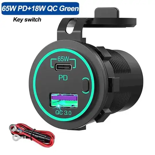

By installing a USB-C PD (power delivery) outlet and skipping the inverter, the drain is lower, and you can essentially skip the turbine or solar panel if you make sure to charge it once in a while. The PD feature also allows most modern laptops to charge from it, again avoiding the inverter.
This solution is safe from most issues, except maybe from curious kid fingers. I would mount the battery under the deck of the treehouse in a lockable box to avoid curios access.
