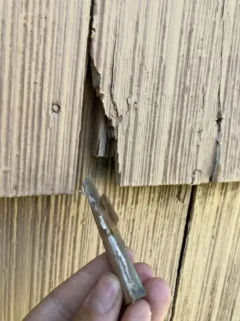

My insurance sent me a letter today that they are cancelling my home owner's insurance, because I supposedly have "asbestos siding" on my house.
I don't really know what counts as "asbestos siding", but I'm 99% sure my home is using wood shingles (redwood or cedar). I don't think the inspector took any samples of the paint or the singles themselves. The home was re-painted fairly recently.
The insurance company's inspection report does not contain any explanation, other than a picture of my house from the street and the comment "this is asbestos siding". No lab report or anything.
Is this "asbestos siding"?
Edit: Located in California - might be one of their attempts to kick Californians off their policies.

    I don't know of any wood or paint having asbestos. You can send a sample off to be tested, the only way to know, but it sounds like your insurance is just trying to drop you and came up with a weak excuse. I would check if your area/country government has an office that oversees insurance. – crip659 Jul 19 '23 at 17:46
    Send a sample, or two for testing - only way to be sure and have evidence the insurance co should accept. – Solar Mike Jul 19 '23 at 17:47
    Easy to tell. Light it on fire. That piece would make pretty good kindling if it's wood, and will sustain a flame. If it's asbestos it won't burn at all. There is no such thing as paint containing asbestos. The scary stuff found in paint is lead, *so don't eat it* - otherwise it's not a big worry. However, what's underneath that? It may have been applied over some sort of hard-board siding. They may know that neighborhood development was built that way. – Harper - Reinstate Monica Jul 19 '23 at 17:50
  • Underneath it is just another wood shingle. I lit the piece on fire, it burns pretty well. So definitely wood, right? – mitchkman Jul 19 '23 at 18:02

    I dunno what goes as "asbestos siding" but that isn't asbestos, it is wood. Asbestos for roofing or tiling was usually added to a mortar/cement mix and would look... "tiley", or it could be woven and look wallpapery (now there is a job you don't want; asbestos-weaver). Used as insulation it could be raw and look fibrous/stony or like rockwool. Asbestos was for a time a positive word, you could get synthetic rockwools that due to fibre length classifies and then all bets are off, any pressed board or rockwool/fibre mat substance from the right era *could* be asbestos, but that, sir, is wood. – Stian Jul 20 '23 at 08:53

    I used to have asbestos-cement siding on a house. On a broken tile like that it would look like grey powder in the middle; like cement. If you drilled into it it would turn to a find sand. It looked nothing like wood except for the fake texture of the surface. It was very smooth and painted very well unlike your picture that looks like it has the natural pits and valleys of wood. – Brad Jul 20 '23 at 13:02
    @Brad it looked like cement because it *was* cement. (Asbestos' long tough threads were effectively "rebar" in the thin concrete sheets.) – RonJohn Jul 20 '23 at 14:25

  • Asbestos siding doesn't crack; it shatters. "it looked like cement because it *was* cement." - "If you drilled into it it would turn to a find sand. It looked nothing like wood except for the fake texture of the surface." – Mazura Jul 20 '23 at 23:58
  • @Mazura "Asbestos siding doesn't crack; it shatters." Because it's thin concrete. – RonJohn Jul 21 '23 at 01:03

  • @Mazura while it wasn't hard to shatter, it can crack too. My parents had a number of asbestos shingles on their house which were split in half through a nail hole and at least some of the time damage would break a corner off as a 1-3 inch triangle. – Dan Is Fiddling By Firelight Jul 22 '23 at 18:24
  • Are the shingles all the same width? I'd think that asbestos shingles are sort of uniform in their dimensions (I'm not at all an expert). Cedar shingles, on the other hand would be irregular. A pic of the house from the street, might clarify things. – Schneb Jul 22 '23 at 23:44
  • "split in half" - It *cleaves*, it doesn't partially *fracture*. – Mazura Jul 29 '23 at 19:07

A lot of asbestos siding was textured to look like wood. Newer mineral siding looks exactly like asbestos (and so, like wood) siding but contains no asbestos. And may still be called "asbestos siding" by some people when the distinction is not important.
For your insurance company to make that call from the street is ridiculous.
The sample in your hand looks like wood to me, but that's not worth much more than the walk-by assessment done by the insurer.
Does it behave like wood? Does it splinter? Do small fibers of it become soft? Does it absorb water and expand like wood? I would say "does it smell like wood", but if it's asbestos you don't want to be sniffing it.

    For what it is worth, it burns like wood (no I did not light the entire house on fire). – mitchkman Jul 19 '23 at 18:04

    Now that I looked at it closer, I remember helping a friend side his house with stuff that looked just like that. It was concrete based, similar to Hardy board. Absolutely no asbestos. HOWEVER!!!! it looked just like the siding on other homes in the neighborhood that supposedly did have asbestos in them. Those homes were built in the 30s and 40s. – RMDman Jul 19 '23 at 20:58
    @mitchkman I'm no expert at all, but I thought the point of using asbestos was to act as a flame retardant. So if it burns like wood, it seems like the asbestos content may be low or nil. But, as I said, I'm no expert at all. – End Anti-Semitic Hate Jul 20 '23 at 10:46
    @mitchkman Then it’s probably not pure asbestos (asbestos melts before it ‘burns’, but you have to get it _really_ hot (as in thousands of degrees Celsius hot) to have that happen). It _might_ still have some asbestos content though, so you should still get it properly tested. – Austin Hemmelgarn Jul 20 '23 at 14:46
Take down a COMPLETE shingle and see what's stamped on or taped to the back of it, if anything. Manufactured boards often have branding labels on them, so you can reorder more of the same pattern. Look up whatever you find.
If you think it is wood, then do a simple burn test on a SMALL, unpainted chunk of it. Use a lighter and if it doesn't start making coals or ignite after 15 seconds, it's in question. DO NOT INHALE. Lots of other chemicals and crap in there.
