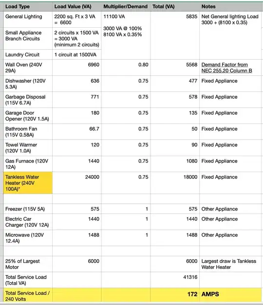

I have added my load calculations and my current plan is use a Siemens ECLK 2225 lug kit at the main panel and replace the existing #2 copper feeder wire with 4 0 Aluminum. Based on this and my newly added load calculations, does anybody see any issues with this?

  • I've added load calculations above and changed my plans to use a Lug Kit. Any thoughts on this solution? – Ted1391 Aug 26 '23 at 01:43
  • @Ted1391 The Load Calc looks close enough... I'm surprised to see no A/C in a home that large but you have some room. And while 1440W is a bit low for EV charging you have at least 3840W in the garage already and that will suffice. Make sure the lug kit is correct for the panel (not the breakers found in it), I see at least one BR breaker in the main. Also get handle ties for the 20A MWBC in bottom right of main. (or a 240V 20A breaker). – Harper - Reinstate Monica Aug 26 '23 at 14:37
