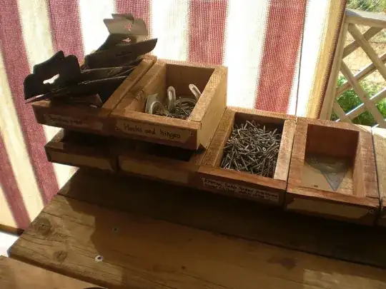

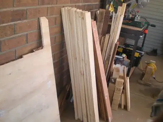

I usually collect pallets from the street, because my parents won't buy me wood for me making stuff for my stuff, they only buy it when I'm making their stuff. For the first time I did it, it was so difficult and hard work, I had a whole day of sour muscle but 80%of the hard wood from the pallets had snapped. I recalled the memory that I did it, and found out maybe I should use a chisel and hammer it in between the two timber that are nailed together, and using the pole principle to pull them apart, then use a the end bit of the hammer and use the same pole principle to pull it out. After taking down dozens of pallets, I also had an experience about pull each nail out a bit each time so the timber won't bend and therefore snap. Never use a hammer to try hammer it out, you will damage the timber and snap it as well. Hammer the chisel in and pull it apart. here's some example of the timber I took down: these are the timber I took down and I filled the nail holes and sanded it with P40
from the front I use them to make some boxes for my stuff
  • Those look similar to much of the free pallets I have reclaimed, time is cheap when you don't have a job. – Ed Beal Jul 14 '18 at 19:39
