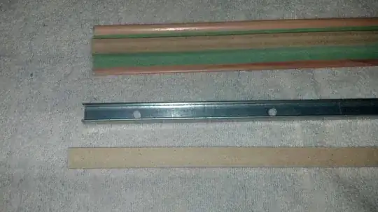

Update - Added picture of T molding pieces if that helps.

  3. Evaluate just where you would place the screws. Looking at your picture I'd say you are going to face screw it into place with brass flat head wood screws from the top. Most likely is a row of screws down the center of the Tee leg. It is also possible that you may place pairs of screws toward the two edges of the Tee leg depending on just how wide the molding actually is.

    As you can see in the photo, the T-molding comes with a channel intended for mounting. The question is really how to mount the channel. – isherwood Feb 07 '17 at 18:52
I would glue the guide bar down with construction adhesive on top of the moisture barrier - given that your moisture barrier is pretty tight. Wait a day. If it is pretty solid then I would put the t-molding in with construction adhesive too... tons of glue and the t-molding with a good amount of weight on it for at least 12 hours. You do need to make sure your t-molding lays pretty flat on each side and adjust the bottom leg of it if necessary.
