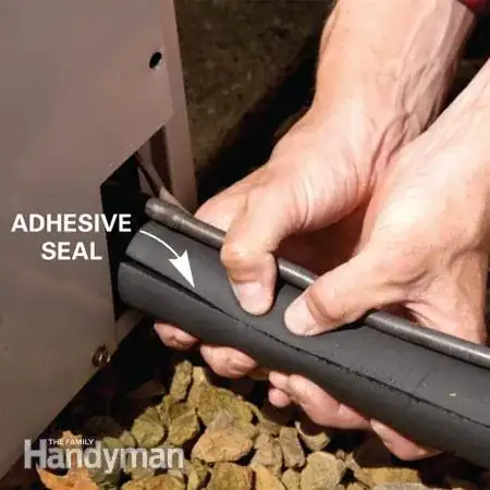

The closed cell (polyethylene) foam with the adhesive strips (covered by a pull-off protection strip) will last much longer and insulate better. You may still need an overlap wrap of tape at the butt joints. The open cell will work, but needs tape along length and is "crumblier".
Closed cell foam with adhesive
Open cell, no adhesive
