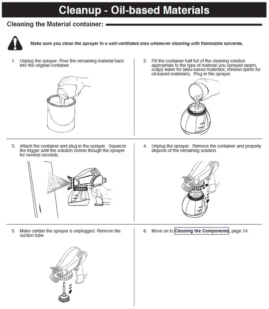

here's a link to the Power Painter manual(PDF) on Wagner's site.. Its a newer version but the cleaning instructions will be very similar.
Cleaning the Container Cleaning the Suction Set Cleaning the Components
