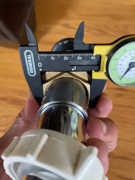

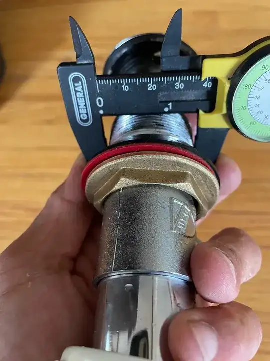

PS Here's pics of the nut I'm trying to torque down Thread diameter Torque face measurement
