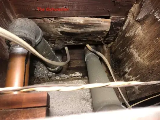

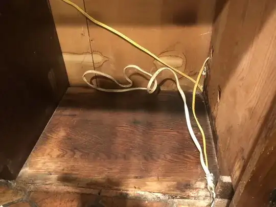

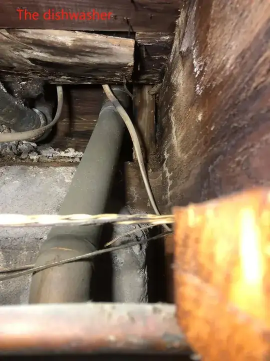

My dishwasher leaked in the night of Aug 1, the water went down into the basement ceiling, and went out to the exterior on top of the basement window. I noticed the leak the next morning. There might be water leak before I bought this house one year ago, but I'm not sure.
Multiple fans are now being used to dry the cabinet and the structures in the ceiling, 3 50-pint dehumidifiers and one AC are used to dehumidify the basement room (RH 35%), and one air purifier to reduce the dust in the air.
I wonder if I can DIY the water mitigation or I must hire some professional. My goal is to prevent structural damage and mold. Is air dry enough? Is desiccant needed? I saw somewhere on YouTube a spray is applied after drying. Is it necessary? What spray I shall use?
Here are some photos.
Where dishwasher was installed. Right side is slightly lower than the left. enter image description here
Basement enter image description here
Outside enter image description here

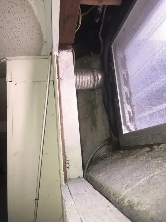

By the window of the basement enter image description here
Inside of the basement ceiling, around dishwasher, from right to left enter image description here

  • This sounds like it was a one time event. However, it's also possible that you mean that this happened over time. Even if it was a one time event, someone could describe it the way that you have if the duration was anything from the result of a single load in the dishwasher to a leak forming while you were on vacation and lasting a month. A lot of longer-term water issues and needs for mitigation depend on how long the issue existed for. Please [edit] to more thoroughly describe how long this was happening for and/or how long the leak existed, at least to hours/days/weeks/months. – Makyen Aug 04 '23 at 18:10
  • @Makyen It's a one time event, and happened on Tuesday night, and was found next morning. There might be water leak before I bought this house one year ago, but I'm not sure. – bobby_yan Aug 05 '23 at 15:58
  • @jesse_b When shall I apply the spray? After how long of drying? Or other indicator? Thank you. – bobby_yan Aug 05 '23 at 16:22
  • That WD is w/e. Picture #7 with its split joist; not so much. – Mazura Aug 05 '23 at 16:55
  • @bobby_yan the sooner the better, you can put it on while it's still wet and reapply a few times for good measure. – jesse_b Aug 05 '23 at 22:14
  • @Mazura Right under the dishwasher (9th and 10th photo), there seems to be a piece of subfloor falling off? – bobby_yan Aug 06 '23 at 04:54

Remove all the stuff (like the false ceiling and the wood paneling/drywall) that is wet and can be replaced easily as its a barrier to let the structure dry. The structural wood is wet, and wetrot/dryrot is your worst enemy. dryrot Kind of a misnomer as the fungal spores are active when moist and eat the cellulose in the wood, which is what gives is strength. The wood becomes soft when this happens and will cause major $$.
Stuff that is an alcohol/glycol based fungicide is what you want. I made my own boric acid/borax glycol mix that is way cheaper than what you can buy, but suggest getting Boracare or Lignum. The wood looks like it may have fungal spores already, so the water has woken them up for a feast. Some of the water cleanup people are hacks and some really know their stuff, but you should do something about it.
