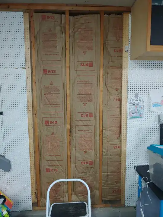

I have a higher stubwall in the partial underground on on a side basement in our house built in the late 70s and recently redid the wall as we had a drain tile installed. I only have the old frame and picture of adding XPS to reduce the amount of moisture in the basement halfway though the install. https://imgur.com/a/DPIlZLA
I think your plans are solid, you don't want regular drywall with direct contact with cement as it will wick moisture and cause mold (why you see it always have a gap where critters like to come through and why foam backer rod is great to keep them from coming in but often skipped in the builder special. I do see some efflorescence (white salt marks) so there is moisture moving and evaporating in the room I think. Do use a piece of plastic taped to the floor to see if water is coming in. If its gets wet the vapor barrier between the drywall and concrete is not the right solution. positive water pressure is a huge reason why a lot of epoxy floors fail because the water causes delamination.
The only things I see would be to make sure you keep the moisture barrier intact. There are a couple spots of grey insulation where maybe air is getting out in the cold months and condensing. x

  • Plastic-bag-on-floor-test doesn't show any moisture, and we've never had any issues either. I think the efflorescence there is from an unfortunate incident when we moved in and the kitchen (right above the white) was leaking without our knowledge. No damage to the insulation either. Glad to hear I'm on the right track, only thing I'm concerned about is if the footer isn't plumb vertical, if that doesn't complicate the drywall there. Foam backer rod isn't a bad idea there though. – WJTownsend Aug 06 '23 at 20:03
