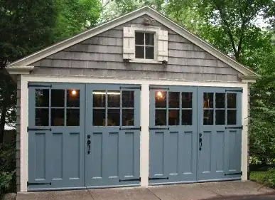

Garage doors that swing outward are a good option.
Image Source
They're sometimes called "carriage house" doors. They're not uncommon in certain parts of the country, particularly on craftsman-style homes. You can get them with powered openers (mounted on the ceiling or wall), but most are opened manually. This type of door has several advantages for your situation:
  • Hangs on hinges like a regular door, so it's easier to install if you're wanting to DIY it. Some even come pre-hung.
  • Safer to operate since there's no risk of it coming down on top of someone.
  • The manual opening version requires zero space or clearance inside your garage.
  • The automatic opening version requires little vertical clearance compared to the opener for an overhead door.
Your opening is rather wide so you may end up installing two sets of doors with a post in the middle. If you really don't want a post, you might consider a bifold door, which can cover a wide span without requiring a massive clearance for the door to swing into.
I would recommend against any option that involves an opening mechanism that's located outside the garage. Garage doors already have a lot of security vulnerabilities, but would-be thieves have an even easier time breaking into your garage when the mechanism is accessible for tampering with or bypassing. A good set of manually-opening carriage house doors with a lock can be just as secure as the entry doors to your house.
Also, don't forget that most garage door companies will give free estimates. Have them come out and walk them through what you want to do. They've likely done something like this before, so they can guide you through what has worked in the past and what hasn't.
