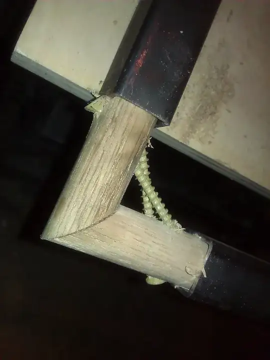

Update 5/25/2013: I went with mike's idea of using corner braces, but with a twist. Instead of 7/8" braces and epoxy, I went with 1" braces and metal framing screws. The results are pretty good (see pic). I initially tried to epoxy several 3/4"braces together as mike suggested, but I think I mixed the compounds together improperly as they would not cure after even 3 hours.
Original Question

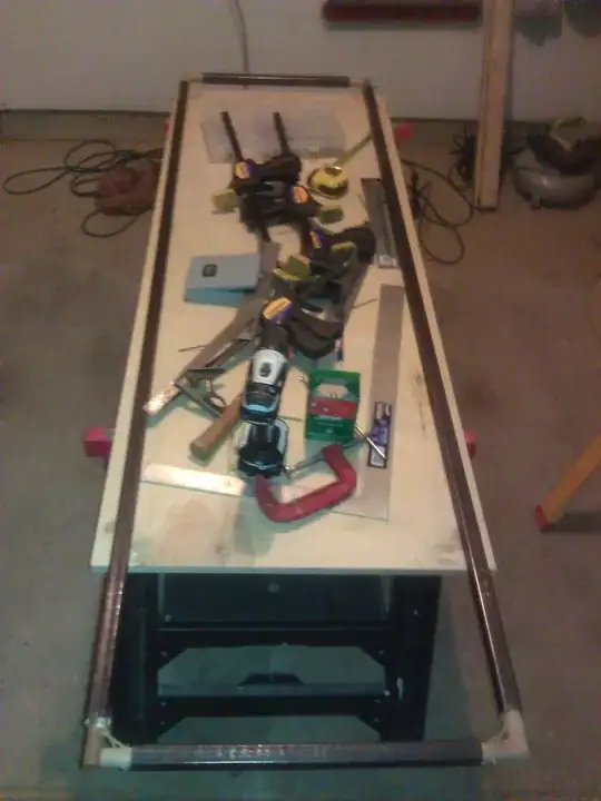

I am trying to make a rectangle frame out of this 1" 14-gage steel tubing. I am sorry to spam SE with more of my soundproof door questions, but, if you must know, that's what this is for.
Originally, I was going to route a dado out of some MDF and line the sides, top, and bottom of the inside of my door with these steel tubes. This would keep the door from warping vertically and horizontally, but a user here by the name of mike (I hope you're reading this) informed me that it wouldn't keep the door from twisting.
So, in an effort to create my own elbow joints to connect these tubes, I took a 7/8" oak dowel, cut it into eight 4 1/2" pieces, pounded them into the ends of the tube, and mitered them. I then shot two screws through either side thinking this would really keep it from twisting. Well, unfortunately, the frame still twists, most likely because the screws are bending.
What I need are sturdy, one-piece elbows measuring 7/8"x7x8". I thought of taking two 1/2" sheets of MDF, gluing them together with Liquid Nails, routing 1/8" off one side, cutting out an elbow, and then pounding that into the ends (I can't find any wood that's 7/8" or 1" thick). Failing that, make the elbow joints out of QUIKRETE.
Does anyone have any other good idea about joining these tubes together in a super-sturdy fashion?
Edit: I should probably state that I bought these lengths of tubing precut from discountsteel.com. Unfortunately, I do not have the ability to cut (this includes mitering or kerfing), weld, or bend steel, so I have to do the best with what I've got. I guess it doesn't have to be as sturdy as a rock, but sturdy enough to resist twisting brought on by warping of MDF.
Latest 1" braces w/ metal framing screws

  • Even when welded, the 1" steel tubing frame will still twist 1/4"+ out of plane with a small amount of force. – mike May 17 '13 at 08:00
    @mike - I totally agree with you. A 1" square tubing frame the size of a door will still twist some. Welding is however the only really practical way to get the frame as sturdy as it could be. To get a frame that would be more suited meeting the needs of oscilatingcretin it is going to require something more like 1.5" or even 2" square tubing that was welded up. Welding is really the only way to transfer the full lever force of one axis into a torsion force in the adjacent frame edge. Any other type of corner is going to introduce some flexure at the corners - the shown dowel pegs for example. – Michael Karas May 17 '13 at 10:45
  • I ordered these precut from DiscountSteel.com. Unfortunately, I don't have the ability to miter steel, let alone cut it. However, thanks for the advice and I am sure it's the best route. – oscilatingcretin May 17 '13 at 12:06
  • Also, I am testing the twisting my laying the frame down flat as you see in the pic and lifting up one corner. This entire frame weighs probably 20 lbs, so I can see how this twisting is occuring. In application, though, the door will be upright. Are you both saying that, no matter what I do, the potential warp strength of the door will be stronger than any joint method I use that doesn't involve welding, bending, or kerfing the steel? – oscilatingcretin May 17 '13 at 12:17
  • @mike: I am impressed with your calculations. I used c-clamps to hold all the joints tightly together so there was as little bending as possible. Indeed the corner raised up just over 1/4" before its parallel corner lifted along with it. – oscilatingcretin May 17 '13 at 16:24

Still, if you are set on the steel tubing and MDF, another way join the four lengths that you already have is to find some corner braces that are about 7/8" wide. They would likely be about 4" long. Use a stack of them at each corner, embedding them in tubing with, say, an epoxy to take up any play.
