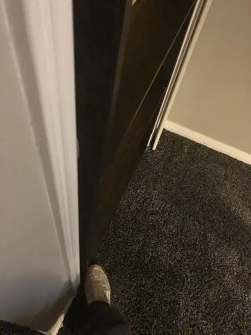

I am aiming to babyproof this unit to the wall. It is three separate, vertical pieces. For the rightmost and leftmost piece, for where they are, there is one stud behind each of them.
I can secure them to the wall by either using the default drywall anchors they came with or I also have these and can secure them to either the drywall (two on each corner) or the stud in the center.
Which is more secure / recommended?
Is there a better, more safe way to go about this?

  • One thing I forgot to mention -- because of the molding on the floor, there is about a 3/4" gap between the back of the unit and the wall. What is the best way to secure this to the wall given the gap? – Marc J Aug 21 '23 at 21:17
    You could use a longer screw that accounts for the gap (Consider an inch of penetration into the stud, 1/2" nominal through the drywall, 3/4" space behind the cabinet, thickness of the cabinet back and L bracket if needed: add all that up for the screw length you'd need. Use cabinet Screws with flat washer-like wide heads, like @FreeMan recommends.) You could also use a 3/4" piece of wood as a spacer at the top. If you can pre-drill holes in the wood at the correct locations you can drive the screws through the wood, or lay a strip of wood on top of the screw shafts while tightening, – Triplefault Aug 21 '23 at 22:13
    100% recommend putting some 3/4" plywood or "1x" dimensional lumber (actually 3/4" thick) behind the cabinet to fill in the space @MarcJ. Otherwise, as you're tightening the screw, you'll be bending the back of the cabinet out of shape and it will fail long before its time. You won't need to cover the entire back of the cabinet, just a couple of strips, maybe 3-4" wide, through which you'll run your screws. One strip at the top, one at the bottom. – FreeMan Aug 22 '23 at 12:32
